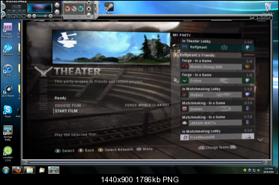

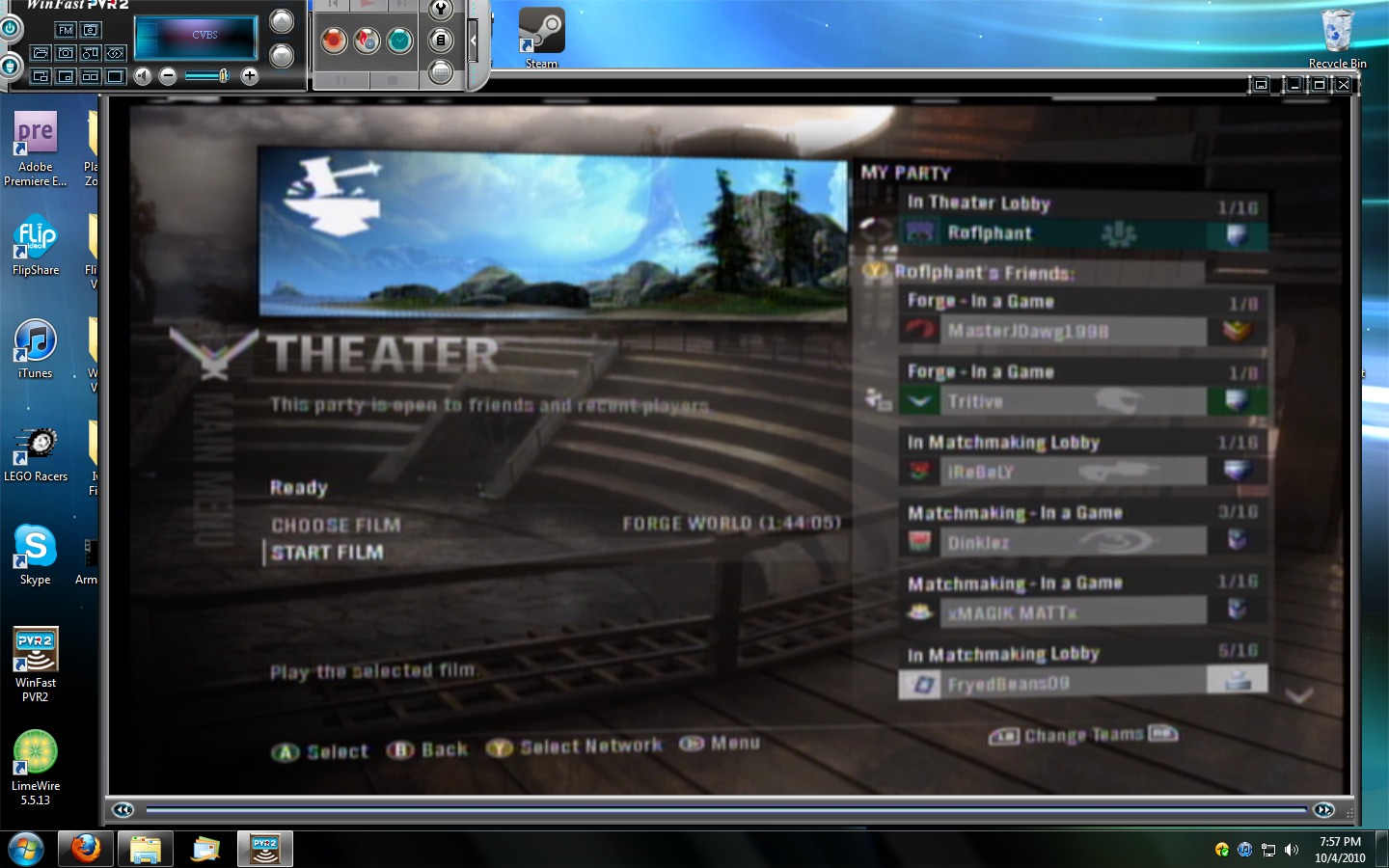

  1. Okay, so i love my capture card, I can record widescreen and all the good stuff, only problem is these annoying lines at the top of my videos that I've lived with forever. I have also seen them on many other capture card videos as well.
    You can see the little blocks or lines of color at the top of the screen in PVR2. I have Winfast PVR2 and I believe the Winfast Px TV 1200.

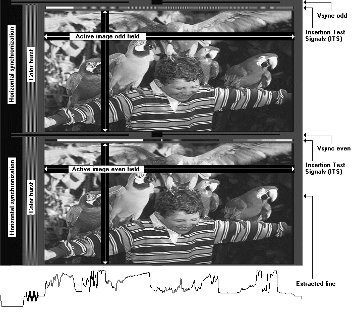

    The Vertical Interval (VI) is supposed to be off screen on a properly adjusted 4:3 NTSC TV however with digital transmission of analog programming, local ATSC stations often forget to blank the data when broadcasting letterbox.
    Various data go into the last lines of the vertical interval including:
    Line 11-18 TVGOS* (Local Electronic Program Guide usually broadcast on the PBS station)
    Line 12-14 SMPTE Timecode (usually used internally and blanked at transmitter).
    Line 12-14 Datacasting (optional)
    Line 17-18 Enginerring test signals (optional).
    Line 19 Vertical Interval Reference (optional chroma reference)
    Line 20 Network data for communication with affiliates
    Line 21 Closed captions, XDS (extended data casting) and VChip data
    Line 22 Used by DirectTV or optional for Tivo Data (broadcast on Ion and Discovery Networks).
    Line 23 begins active NTSC video.
    Many tuner capture cards start capture at line 21 so they can decode closed caption and V-Chip data.
    A visual display of an NTSC frame gives a useful explanation of what you see.
