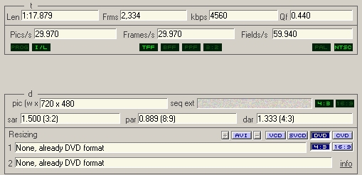

    By the way, does anyone know why the duration reported by GSpot is wrong? I noticed it on other video files as well. (v 2.70a)

  2. Maybe the DVD isn't supposed to fill the screen. Many movies are wider than 16:9 and should have black bars top and bottom on a 16:9 display.
    GSpot reports the VOB file as 4:3. So it should have pillarbox bars left and right.
    Jul 2001
    Those 'black bars' are part of the picture and are supposed to be there. That's why gspot is report 4:3. The best you can do is zoom and lose part of the picture.
    I'm still amazed how many people are willing to distort video so they can 'fill the screen'. Sorry, doesn't work that way. Well, it can, but there's always price to pay.

    Where did you get "PAL"? It looks very NTSC to me (480 width and 29.97 fps). And without looking at your clip, I'd suggest it's a 16:9 video letterboxed in a 4:3 clip. Regardless, technically it's still a 4:3 video as Jagabo says.
    What are the steps to recode this DVD on my PC in order to get a full screen picture?
    Yes, there is a price to pay as Neomaine mentioned and one method is a full re-encode.
    If you want a full, true, wide-screen picture, without distorting the picture, you'd probably need to crop 60 pixels off the top and bottom, resize back to 720x480, and re-encode with a 16:9 aspect ratio.
