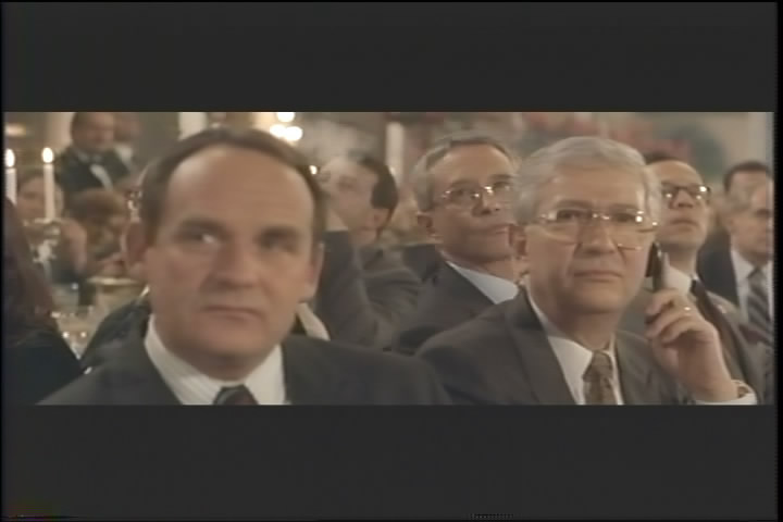

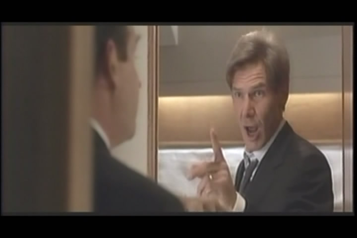

    Ok I had some trouble getting it to encode last night. I was able to get a completed encode today. I'm burning the dvd now. It is FANTASTIC!
    Check for yourself:
    [img]airforceonewide.jpg[/img]
    [img]airforcewide.jpg[/img]
    I did end up buying the widescreen version of Air Force One at the book sale after all and it seems to be in perfect shape.
    Its obviously not as sharp as a real dvd print would be but I'm thrilled with the vhs transfer.
    Thanks a lot davexnet. This was great. Now if only I get a hold of more widescreen vhs movies this would be a perfect transfer option. As I said earlier I do have a few other widescreen vhs tapes but I already have them on printed official dvds in widescreen so I don't need to transfer those.

    I'm not sure why the two snapshots are different in width. Both were taken with mpchc. It could be that I took one from the original capture file and the other was off the dvd folder after conversion - don't know for sure.
    But the dvd plays just fine in the proper proportion so that is all that matters. Thanks again.
