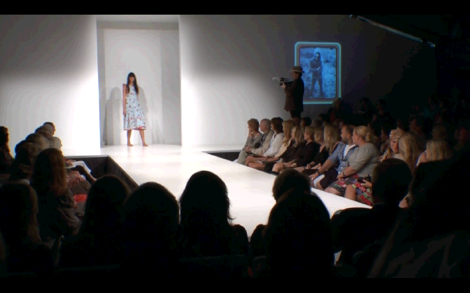

    I've just been provided with lots of unedited 1080 footage of an event and would like to edit it into a small video but the quality of it seems very poor. I'm not sure if this is due to the camera it was filmed with, or the codec the video has been supplied in (Microsoft Video 1 CRAM - I've never even heard of it).
    Here is a screengrab of the video in question: https://forum.videohelp.com/images/imgfiles/MvTOm.png
    I have a few questions about it:
    • Is the codec to blame for the quality, or does that look like a camera issue? Everything seems very 'pixelated'.
    • Is there anyway to improve that colour 'banding' effect you see on the white background? Is that down to the compression used?
    • Is there anything else you guys would recommend to generally improve the overall quality? The final edit only has to be 720p.

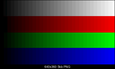

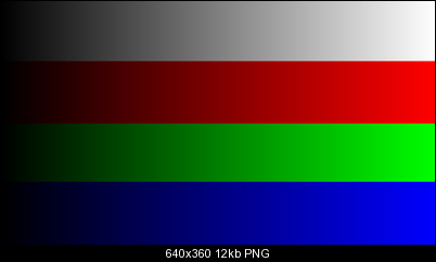

  4. CRAM (Microsoft Video 1) is a very old, inefficient codec. It uses 15 bit color (5 bits each of RGB), hence the banding.
    24 bit RGB Source:
    After CRAM:
    The best solution is to get the intermediate to reencode with MPEG 2 or h.264 and FedEx new discs to you.

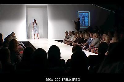

  7. The gradfun2db filter for AviSynth works pretty well with that image:
    Beware, it might not work as well with other shots. And may over smooth faces and other detail.
    WhateverSource("filenname.ext")
    gradfun2db(10)
    Also, I believe that video was originally a standard defintion video. So downscaling back down to SD frame sizes won't hurt it.
