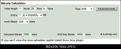

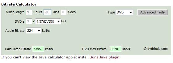

    You are doing fine.
    Your camcorder is recording CBR (probably 25 Mb/s DV format). If your edited program is less than or equal to an hour, you can use 9500 Kbps CBR for MPeg2 encoding. If it goes long, say 80 minutes you would use two pass VBR with 9500 Kbps as max bitrate and 7300 Kbps for average (from bit rate calculator).
    https://www.videohelp.com/calc
