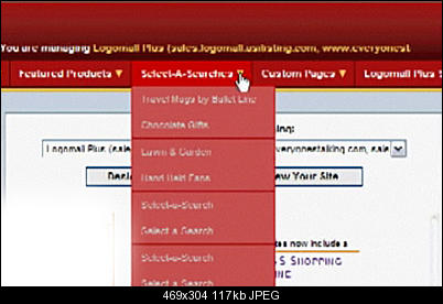

    i'm not sure that i can show yo uthe video

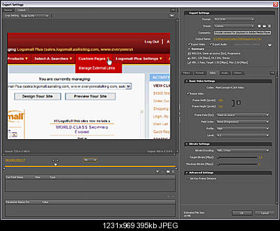

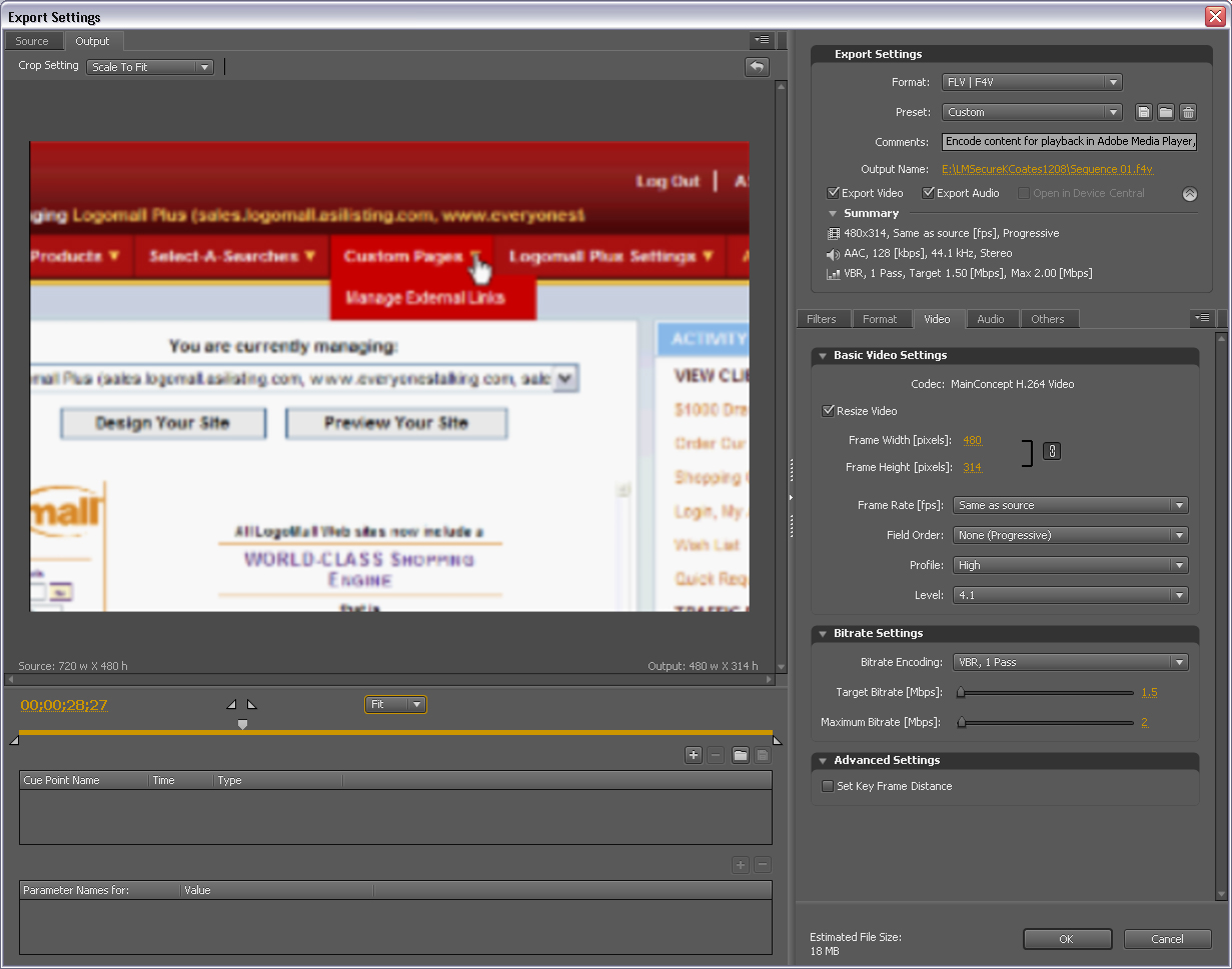

    whoa sorry. give me a minute this computer is a piece. i'll send a screen shot
    Sep 2010
    Pennsylvania
    thats the source screen, you can see how i'm trying to crop it to square instead of widescreen

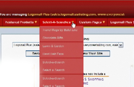

    quality when i resize

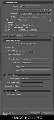

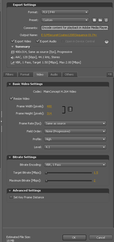

    Sep 2010
    Pennsylvania
    my settings
  15. Is your source widescreen DV-AVI ?
    Personally, I would export it as is (interlaced, not resized, and a lossless format like uncompressed or lagarith), then use 3rd party programs to deinterlace , crop, resize and encode. PP has a very low quality deinterlacer and soft resizer. It is somewhat improved in CS5, but pretty bad in CS4. I skipped CS3, so I cannot comment on that
