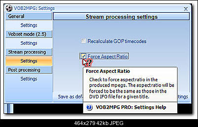

    I have a build in the wings which will force the AR to that of the IFOs. i.e if it is 16:9 in the VOB2MPG "tree" then so will be the output mpeg (even if they currently output as 4:3):
    PM me if you would like to try it.
