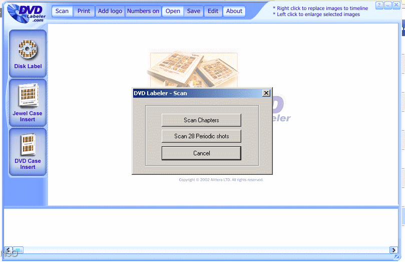

  10. Member p_l's Avatar
    Montreal, Canada
    Nice find, scorps!
    I tried it on my dual boot machine. I couldn't get it to work in Windows 7, but it does work in XP. Depending on how the DVD is authored, it may just give you title thumbnails, not chapter thumbnails. On other DVDs though, it gave me chapter thumbnails as well. There's also an option to just gather essentially random thumbnails.

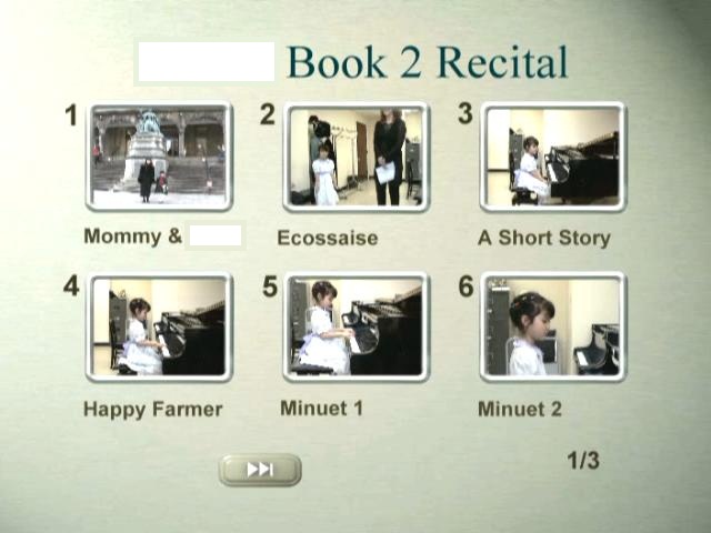

    But hey, it does what you asked for, moxiecat, and there's a free trial. Previously, when I wanted this type of thumbnail cover, I just saved a screen grab of the thumbnail menu I created as it played in WinDVD or something,

    This program automates the process.
