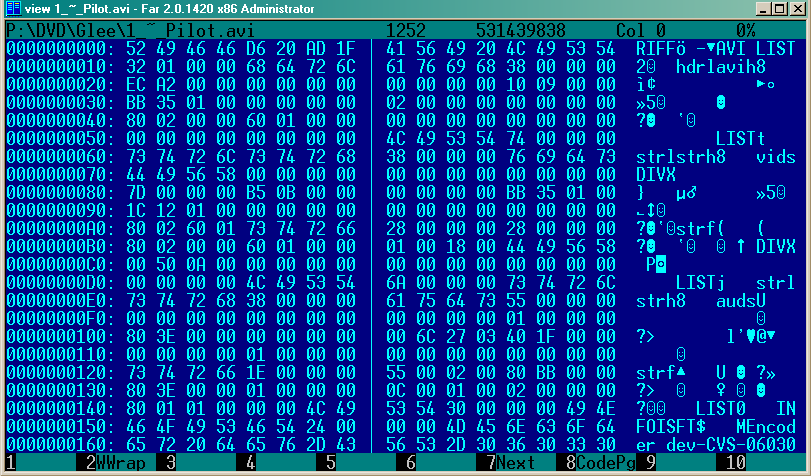

    Have a look at the data at the head of the file.
    I don't know if there are any built in Windows apps that can do that, but any hex editor can. Just Google for one.
    Almost every file has a "signature" at the very beginning saying what program made it, and details of the format; and usually at least some of this is in plain text. Far more info than just a random extension gives you.
    For instance this is the beginning of a video file, as seen by FAR. It's pretty obvious that it's an AVI file, using DivX codec, made by Mencoder.

    ...or try MediaInfo, to see if that can tell you anything about the files?
    AlanHK: I usually use WnBrowse for things like that... view a file's content in both hex and text mode, and it's a good ASCII text viewer as well. (It's not a hex editor, though, just a viewer, so that might be safer if one's concerned about accidentally modifying the file.)
