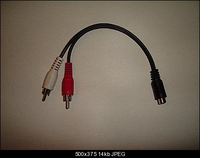

  3. Use a y-adapter to split the mono audio to both the left and right audio inputs on you capture device.

    my VHS player only has yellow and white - no red.
    so with that "y-adapter", I suppose I will plug the white into the black end and connect the white and red to my Dazzle?

  5. Originally Posted by yic17 View Post
    Yes.
    No, that one has a mini phone plug at the the single end. You need a female RCA plug.
    http://www.buy.com/prod/rca-ah201n-a-v-cable-6-splitter-cable-rca-female-audio-video-r.../90112006.html
