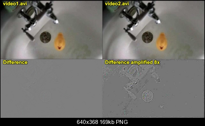

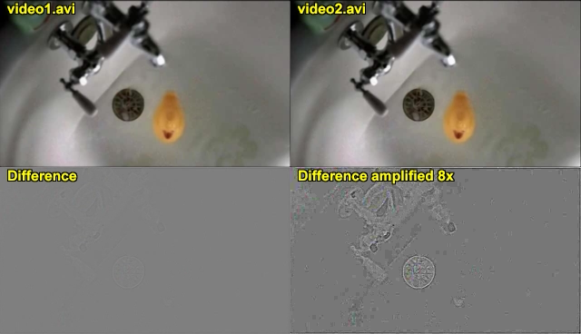

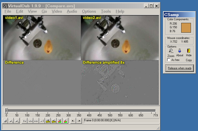

  5. You can use AviSynth's StackHorizontal() or StackVertical() to put two videos side-by-side. You can use the Subtract function to see the differences between the two. And Levels to amplify those differences. Here's one script that shows the two videos side-by-side, the differences, and the differences multiplied:
    name1="video1.avi"
    name2="video2.avi"
    v1 = AviSource(name1)
    v2 = AviSource(name2)
    sub = v1.subtract(v2)
    substrong = sub.levels(112,1,144,0,255)
    StackVertical(StackHorizontal(v1.subtitle(name1),v 2.subtitle(name2)),StackHorizontal(sub.subtitle("D ifference"),substrong.subtitle("Difference amplified 8x")))

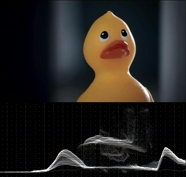

  8. Yes, I use Interleave() a lot too. Then I flip back and forth between the same frame in VirtualDub. And I use a screen magnifier to zoom in. Some other useful tools are the VideoScope() and Histogram() filters for adjusting levels. CSamp is good for scanning RGB values of pixels.
    The above compare script produces:

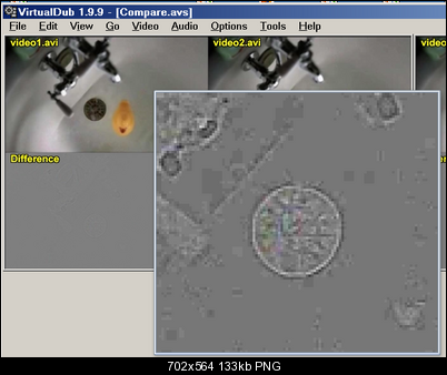

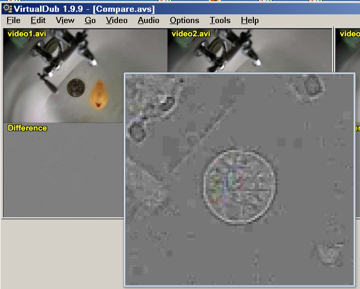

    A zoom utility (zoom box follows mouse cursor):

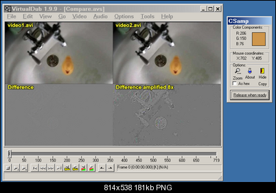

    CSamp in action (mouse cursor was over the yellow ducky):

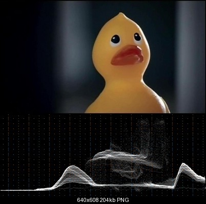

    VideoScope() filter:
