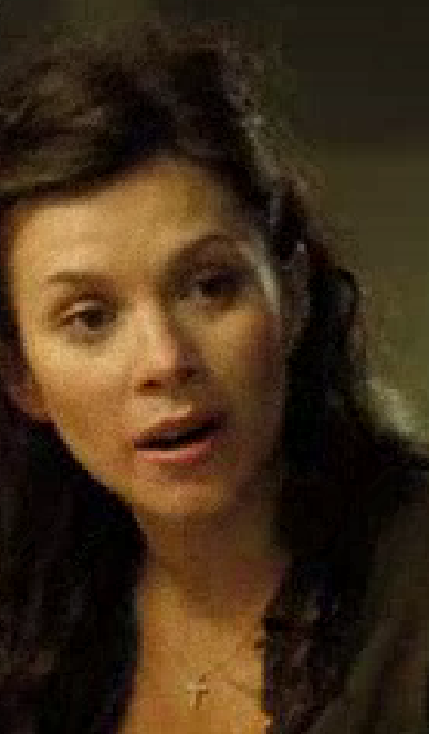

    I want to re-encode an movie with subtitles and watermark.
    I use VirtualDub latest with video filter option to add this.
    Though after full processing mode video and direct mode audio.
ID:	3619Click image for larger version

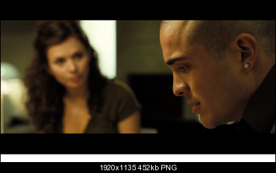

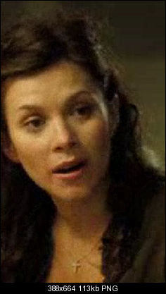

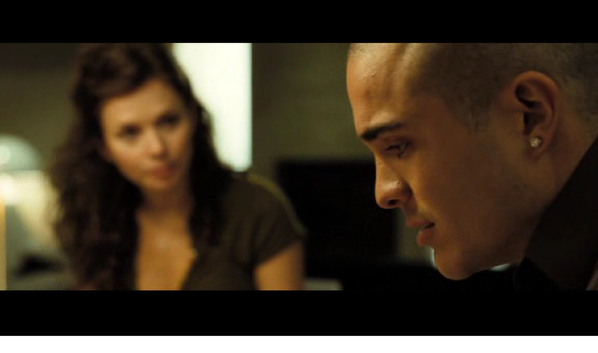

    the 2nd image is original movie i reencoded. the 1st image is the movie after reencoding. the 1st image has dotes and many interface problem with VLC. where as 1st image works perfectly. I use Xvid compression. Original is also Xvid.
    I do everything in single pass because i do want file size of my movie below 1000 MB so i also do adjust target quantiser. But default value of 4.0 also show this. If make this 1.0 quality is preserved but size exceeds 3 GB.
    How do i preserve the original video with adding video filter subtitle and watermark.

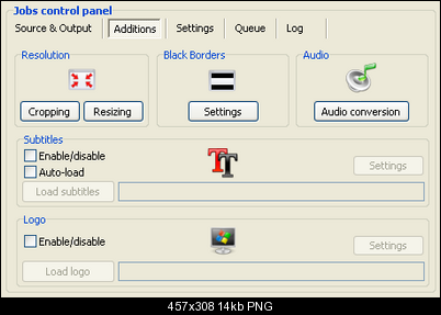

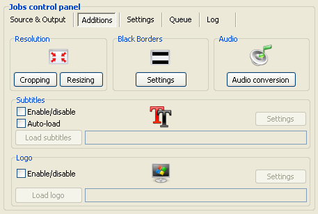

    Sorry, Actually, I have an two images, of both size 2 kb .bmp image of 133*20 pixel. One i have to place at left up corner and other at right hand up corner. Different videos have different pixel - One large image might not help.
    But in AVI ReComp, I have only one subtitle option there, see bottom of the picture. I want to subtitle option. Iam only using AVI ReComp software.

    Well that is possible in Virtual Dub, I want to do this in AVI ReComp, Sadly what should be the background behind the watermark writing, Text is in gray colour. Its like showing Copyrighted by - XXX, As i said at above comment there are two pictures to be placed differently. This question is more important then 1st.

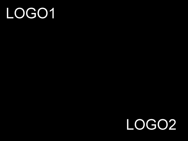

  14. Can't help you with AviRecomp. If it supports transparency, and your images are static, you can use one large image instead of two small images. For example:
    two logos in one image:
    alpha (black is transparent, white is opaque, gray in-between):
    Some programs let you specify a particular color (eg, black) as transparent when using a single image. Or they may explicitly support alpha channels embedded in images.

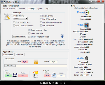

    There is an option of this - Edit avs script
    It uses VirtualDubMod, how can i do it.

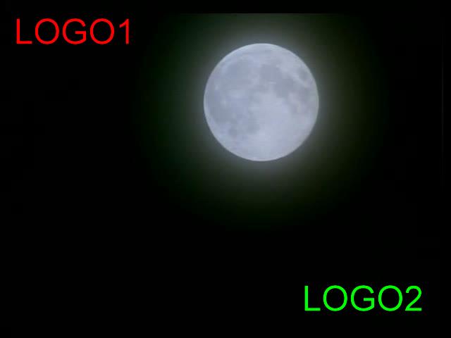

    Two logos in one image:
    The alpha mask:

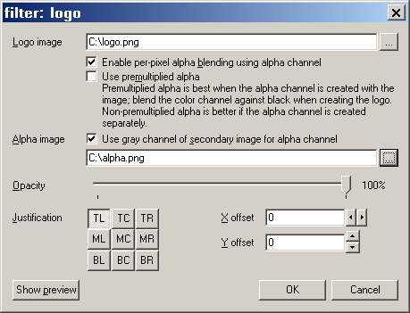

    VirtualDub's logo filter:
    Result:
