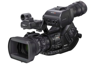

    still waiting for the mediainfo. and what cam exactly are you using? the only sony ex3 i am aware of is this mpeg-2 xdcam.
  13. Sorry i will post mediainfo as soon i'm home
    Yes this is the model Sony EX3 and it records to MP4 Format.
  14. That looks like a good camera. And if your shooting 25p you should be able to get decent results on DVD. Obviously, you'll take a resolution hit 1920x1080 (?) to 720x576 (PAL) or 720x480 (NTSC). But at high bitrates (8000+ kbps) there won't be too much macroblocking.

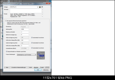

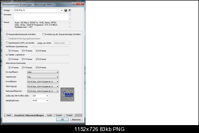

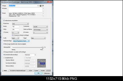

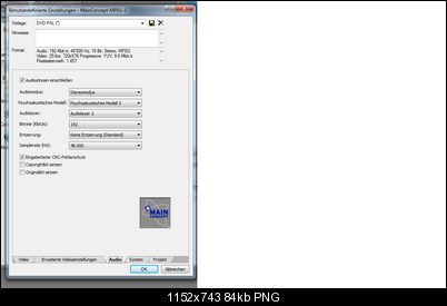

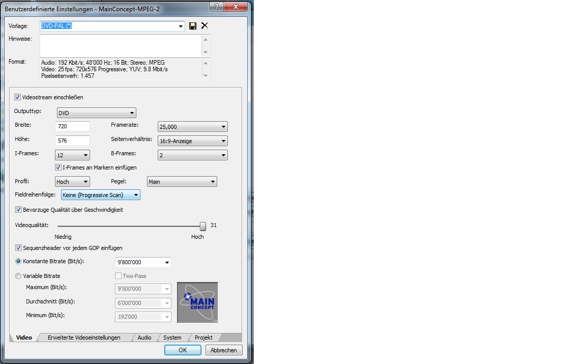

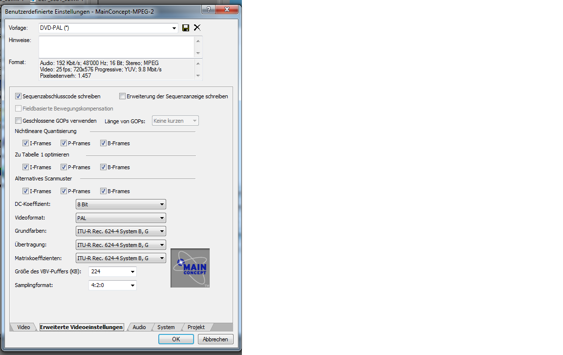

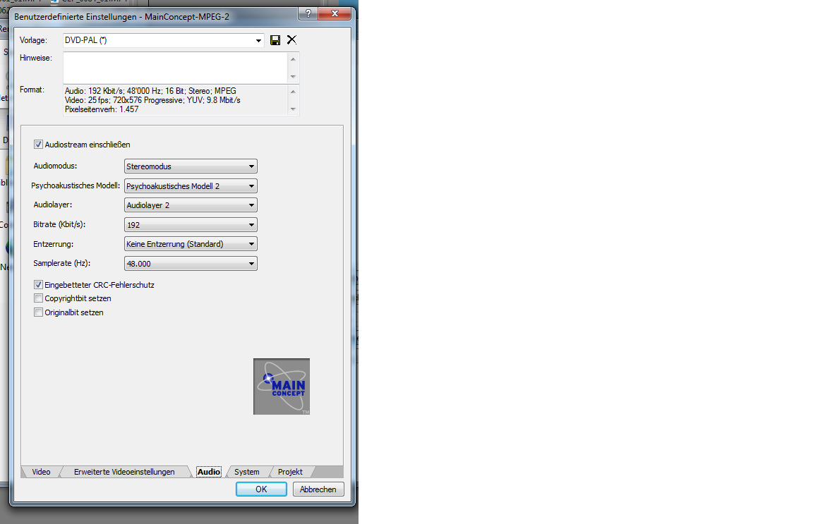

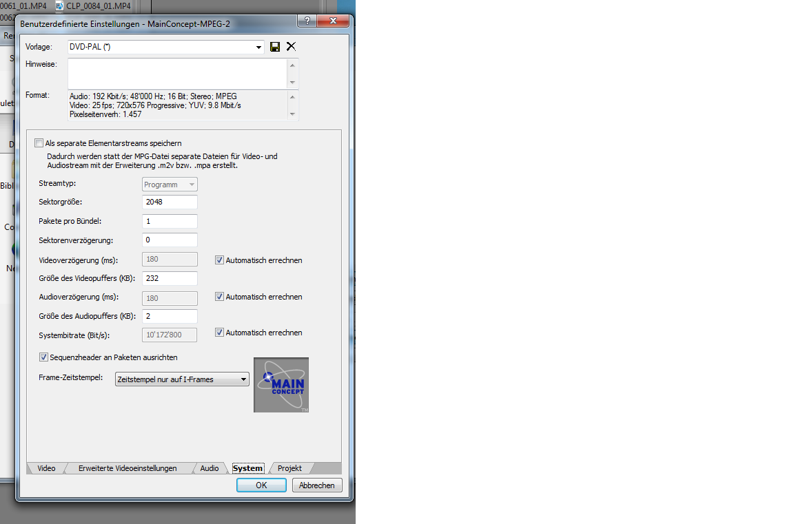

  18. Click image for larger version
ID:	3624Click image for larger version
ID:	3625Click image for larger version
ID:	3623Click image for larger version
    I have included my vegas render settings and source and rendered file for donload directly with rapidshare.com
    Source: http://rapidshare.com/files/421718225/CLP_0032_01.MP4
    Rendered: http://rapidshare.com/files/421724654/Rendered.mpg
  19. I think you are expecting too much from a standard definition DVD MPEG encoding. Remember you are downsizing a 1920x1080 frame to 720x576. Your MPEG video looks about like I would expect. You can get slightly sharper results downsizing with a sharper resizing filter, or by using an explicit sharpening filter. But you will start getting over-sharpening halos if you go much sharper.
  20. I agree with jagabo , you won't be able to improve much on this - the major limitation being standard definition DVD
    The other thing you might consider is a mild denoising filter. You have fine mosquito noise in the source (as well as the encode)
  21. aBigMeanie aedipuss's Avatar
    Oct 2005
    666th portal
    the mainconcept encoder used by vegas just doesn't do much better than what you have there. a step up would be to use cce sp3, but it costs more than vegas just for the mpeg-2 encoder and you'd have to frameserve it, as sp3 won't take your source video as is.
