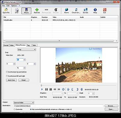

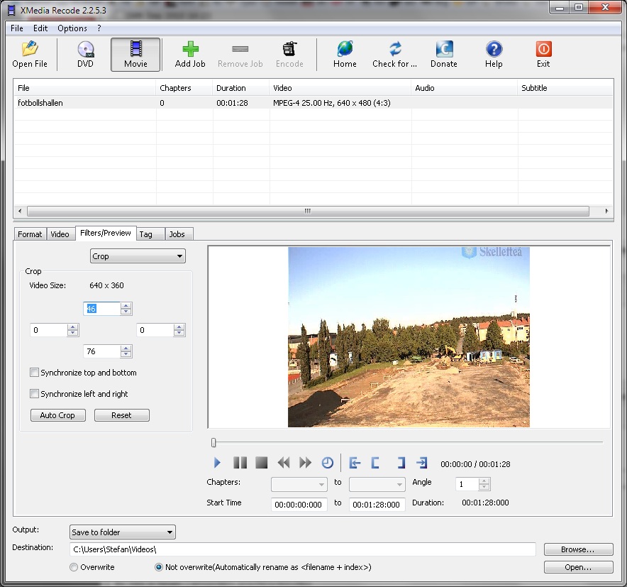

Crop it to 640x360. Use for example xmedia recode, open video, under format choose avi and video codec xvid(mp4 with h264 might also work fine), under filters/preview choose crop and crop to 640x360(you can try use the auto crop-button also). Add job and convert.

Is it correct that i set the resolution first to 640x360 and the crop 60x60 (top and bottom) ?
Also is it best if i use Tunebite and then "Keep Original" for audio and video and encode it in xmedia recode?Last edited by Crueltylizer; 26th Sep 2010 at 09:05.
I guess so. But try and try and try. And yep you can keep original for the audio.
