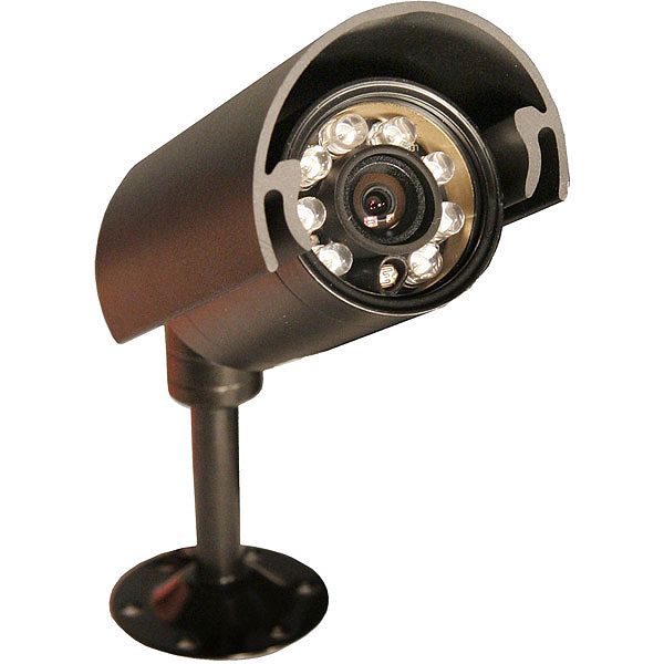

    Is this for a security camera? Normal is IR LED lighting (invisible to perp).

    Most color cameras have a problem with ~1lux. Will a model with a infrared illuminator work for your application? Or a black and white camera? They have B+W cameras available down to .001lux. Though not for IP cameras.
    The mounting location, distance of cable run, amount of available light, distance of the subject, all determine camera choices. I assume outdoors. Generally for night use a B+W camera may be a better choice. Color cameras mostly operate as B+W cameras anyway in very low light situations. The type of light matters also. Mercury vapor lights don't have enough infrared for night illumination. Metal halide or quartz lights are a couple of choices. If you want to operate with no visible light, consider a infrared illuminator if the distances aren't too great.
