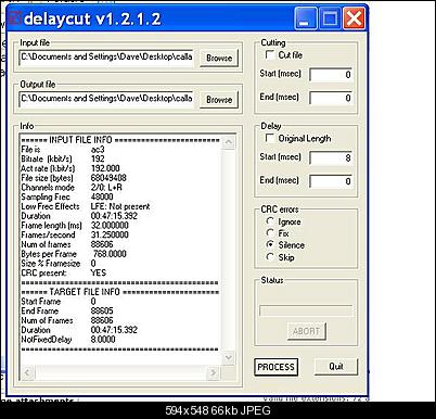

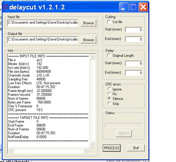

    If I enter the delay manually, as shown in pic, the input and target info look the same. After processing, if I reopen Delaycut and load either original or fixed audio, their Input info looks the same, likes there's no change.

    LOG
    [Input info]
    Bitrate=192
    Actual rate=192.000000
    Sampling Frec=48000
    TotalFrames=88606
    Bytesperframe= 768.0000
    Filesize=68049408
    FrameDuration= 32.0000
    Framespersecond= 31.2500
    Duration=00:47:15.392
    Channels mode=2/0: L+R
    LFE=LFE: Not present
    [Target info]
    StartFrame=0
    EndFrame=88605
    NotFixedDelay= 8.0000
    ====== PROCESSING LOG ======================
    Number of written frames = 88606
    Number of Errors= 0
  5. 8ms isn't typical. No one can hear any synch problems if the 8ms hasn't been taken into account. Since it's said that most people can't tell the difference up to about 100ms, even if your ears are especially sensitive it's not all that important that you adjust for 8ms or 16ms or other super low numbers. I was testing with one I had handy with a delay of -137ms and the before and after sizes were several KB different. Also, I believe you're correct that it may not adjust if the delay is less than 16ms because an AC3 audio frame is 32ms long. Your log file says that your 8ms delay wasn't fixed. WAV audio will always be adjusted because the frame lengths are much smaller. But I'm far from an audio expert and someone that knows more and knows better may want to chime in.
