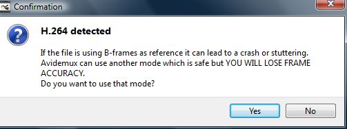

    I go ahead and append my two files together, and the audio horribly scratchy on the second video! I can't even see anything, past the intro, it's all a still picture and tons of static.
    I tried both the "safe" and non "safe" option it gives me when the H.264 detected message comes up, and they both result in static.

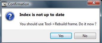

    I see this.
    Then when I hit no, I see this...
    Then I hit yes. and I See this!
    No matter what combination I use, it all ends up with a static filled second half of the video.

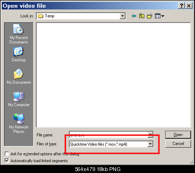

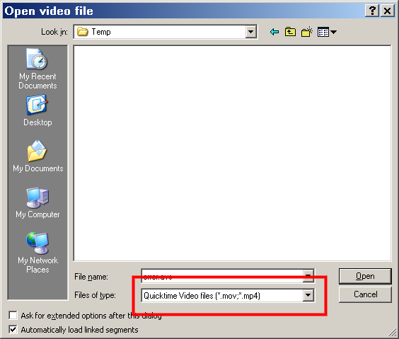

    To use AviSynth you'll need to create an AVS script that uses DirectShowSource() to open the video. You'll also need Quicktime or Quicktime Alternative, and probably ffdshow.
    Or you can get the MP4/MOV source plugin for VirtualDub. You'll probably still need ffdshow.
