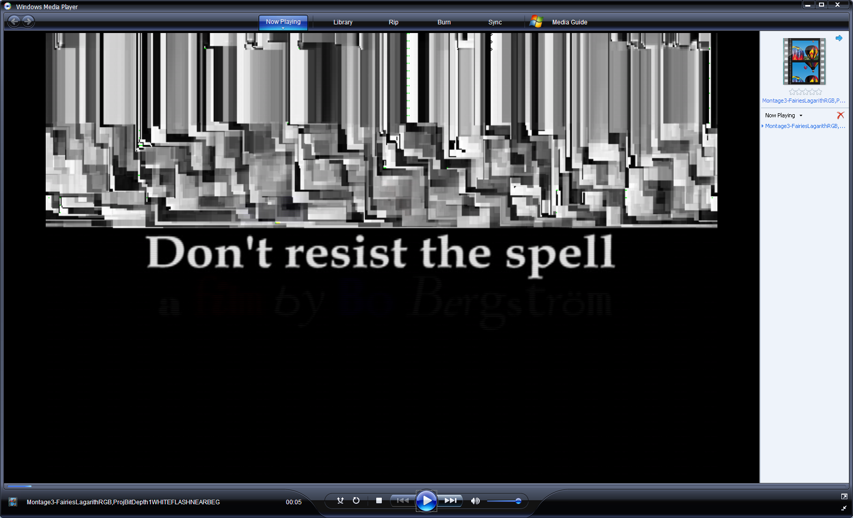

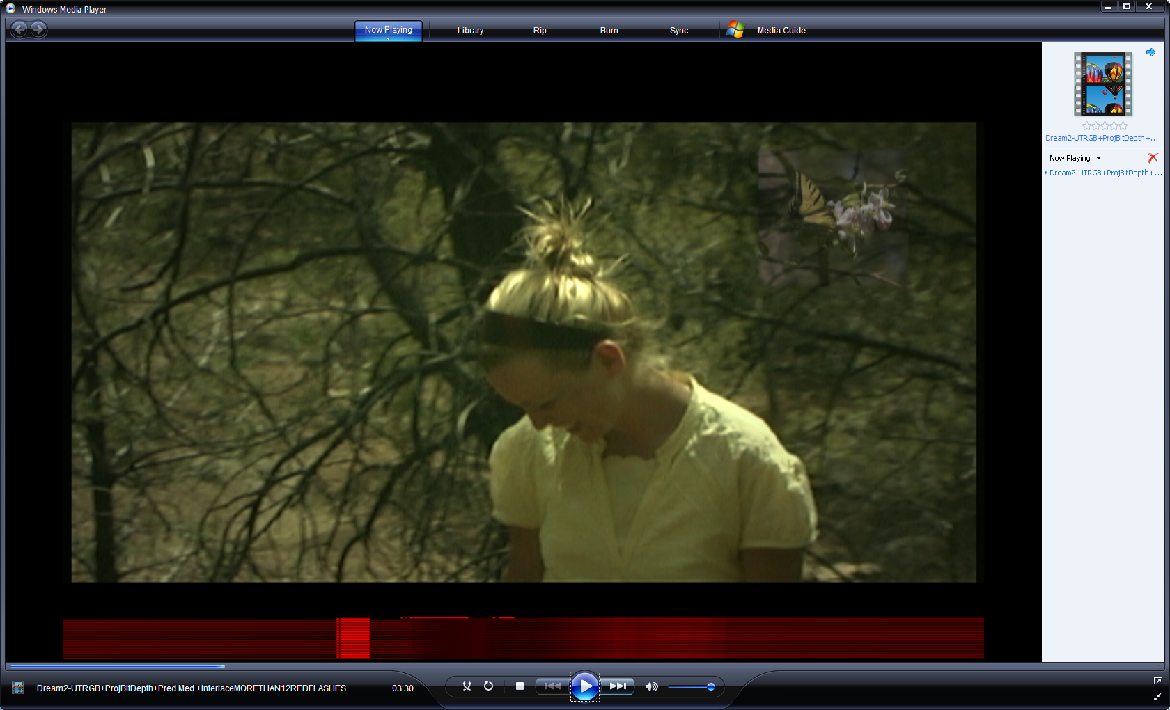

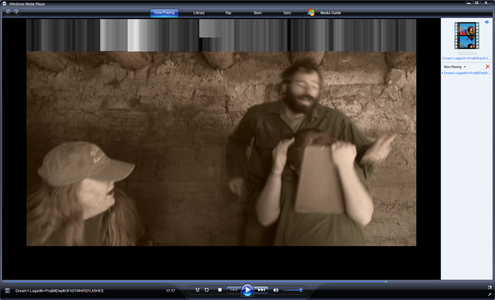

    Hi. I have a 157-minute movie that I’m trying to losslessly export in sections from Premiere Pro 2 as an AVI, then transcode in HC Video Encoder to MP2 for authoring in TMPG Authoring Works 4. The final use will be factory-replicated DVDs to play on TV. TMPG works fine, but I cannot get Lagarith or UT Video codec to function without introducing artifacts into my AVIs. With Lagarith, these are rough horizontal white flashes (fraction of 1 second) in the upper quarter of the screen (upper letterbox area), and in UT Video (RGB), color flashes (fraction of 1 second), usually in the lower letterbox or entire frame. I’ve tried various settings of the codec and usually choose Maximum Bit Depth. Most of the resulting AVI looks excellent, but I don’t want to introduce artifacts. Under what conditions would these codecs produce artifacts? How can I avoid them? (I do not mind huge file sizes for lossless encoding.)

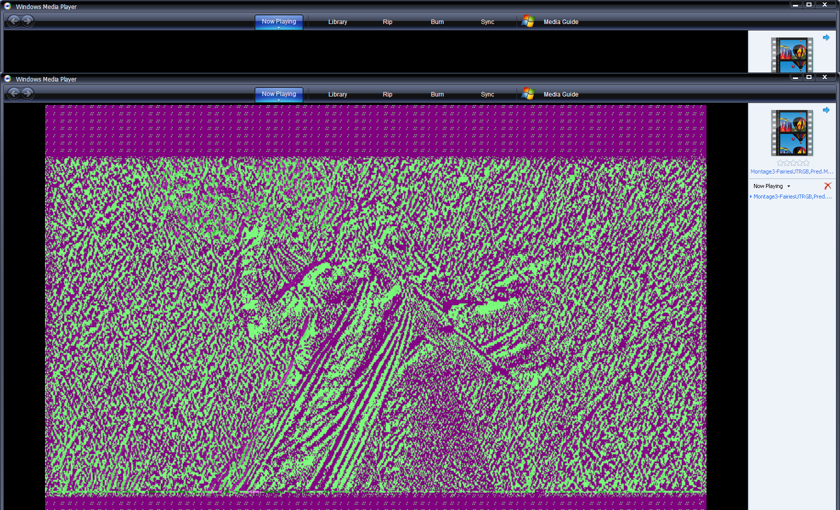

    POISONDEATHRAY, many thanks for these notes. I've gotten HC 025 workflow sorted out, and your precise Avisynth script #2 was the key, followed by my naming the HC output before starting to encode. So I'm now able to use HC for transcording to M2V. I've discontinued using 10-bit depth for Premiere Pro 2 Export, but unfortunately artifacts continue.

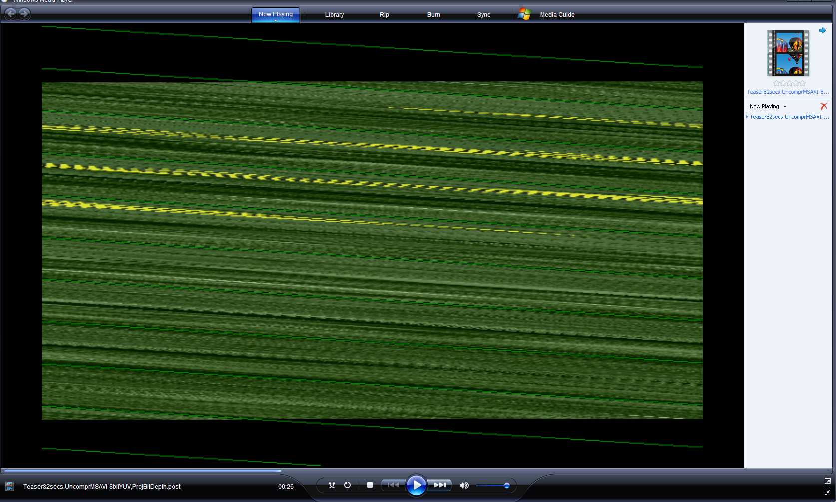

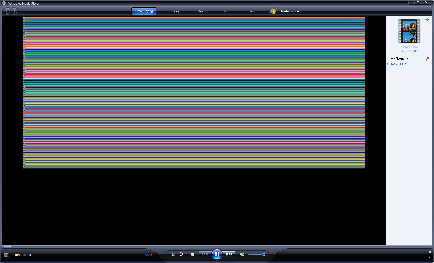

    I'm attaching 6 screenshots to show what the various artifacts look like. Curiously, all Lagarith artifacts are B&W in the upper letterbox space and all UT artifacts are red in the lower letterbox space or in fullframe colors...does that tell you anything? I'm determined to lick this problem so I can have a lossless-encoded but artifact-free movie. My experiment in exporting from Premiere using Uncompressed MS AVI produced only gibberish, in both 8-bit and 10-bit (screenshot attached).

Name:	artifact Lagarith-upper B&W1.bmp
Name:	artifact Lagarith-upper B&W2.bmp
Name:	artifact UT-lower red.bmp

Name:	artifact-uncompressedMS AVI screenshot.bmp
Name:	artifact HuffYUV-won't play.bmp
  7. Can you try opening the various exports in vdub and check for artifacts on those frames ? The media player you are using in those screenshots is direct show based, not VFW based, and not all of those formats have a directshow decoder with the acm/vfw installer
    If that doesn't solve it, I think this is a PP2 problem . The lagarith artifact looks very familiar - I remember reading about incompatibilities with PP2. I don't recall seeing any of these after CS4 or 5 . I'm at a loss explaining the others, especially uncompressed
    In PP2 , is there another option for uncompressed AVI ? In later versions , you can select uncompressed AVI in different categories and some give different fourcc's. - What I'm trying to say is see if there are any other uncompressed AVI export options

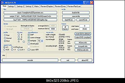

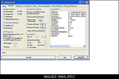

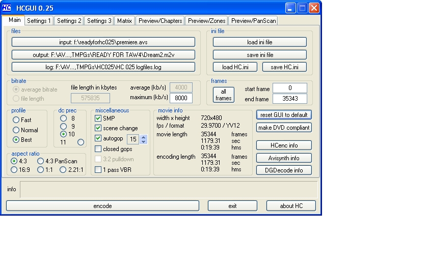

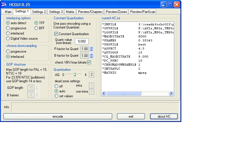

    The second script worked for me. For future readers, I'd stress the importance of filling-in HC's output and log names+locations before encoding, and of selecting "Make DVD compliant." Here are the settings for my letterboxed 4:3 movie:
Name:	HCGUI 025 screenshot-B.JPG
ID:	4160Click image for larger version
Name:	HCGUI 025 screenshot-A.JPG
    Having learned how to use HC-025, I ended up not using it in my workflow. Since I definitely wanted to use TMPG Authoring Works 4 (TAW4) for authoring, I brought three samples into it for comparison:
    1) plain AVI exported directly from PPro2 with no lossless encoding. 2) AVI with Huffyuv-211 lossless encoding. 3) AVI with Huffyuv-211 processed through HC-025. #3 produced the least clean footage--HC added barely visible "borders" around the feet of letters in text, an artifact that was not present in #1 and #2. Since #1 and #2 looked the same, I ended up using #2: AVI with Huffyuv-211 imported into TAW4.

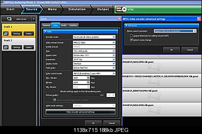

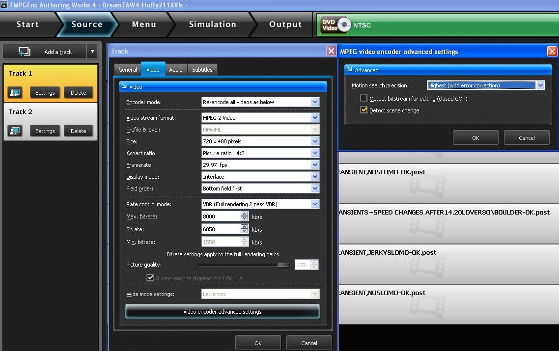

    TAW4 with its onboard Intercom MPEG-Video Transcoder and its video settings probably made a great contribution to my DVD's visual quality. TAW4's video settings are not obvious; they're at the upper left when in "Source" view. For each Track, click Settings>Video, and make your selections. 8000 bitrate is the highest recommended by Craig Hanna at DiscMakers, with 1550 bitrate as the minimum (which answers one of my earliest questions in 9/10), and 6050 for average bitrate for my particular file size. Then click Video Encoder Advanced Settings and choose Highest (with error correction). Here are my settings for my 172-minute DVD-9.
Name:	TAWA4 final Dream video settings.JPG
