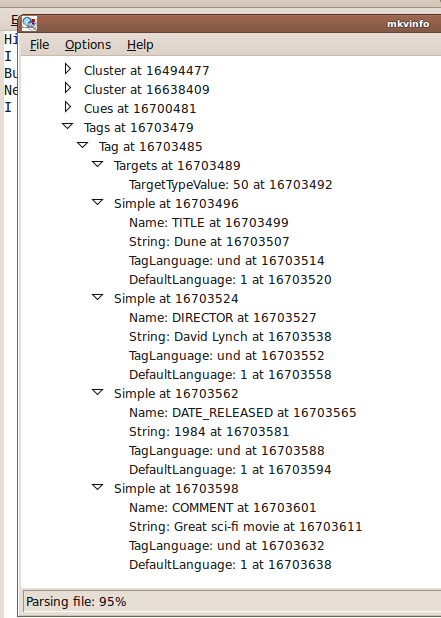

    You can use mkvinfo GUI to view the tags.

  10. Member bat999's Avatar
    Feb 2008
    Good work Mr Hangman.
    I had already used the method you've described with an xml file.
    Using the 'Basic Movie' example from this page:- http://matroska.org/technical/specs/tagging/example-video.html
    But mediainfo won't show the tags.
    Neither will VLC or mPlayer.
    So I thought the method was no good.
    I never thought to try viewing them with MKVinfo.
    Now using MKVinfo with the 'Options' > 'Show all elements' I can see them.
