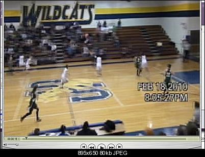

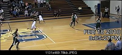

    I only get the 'glowing' when I watch it on the television, but you can see the difference in quality in the attached screen shots.
ID:	3527Click image for larger version

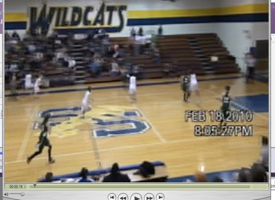

  10. frustration . . . I tried aedipuss suggestion and I get a .mpg file but I lost the quality. It's fuzzy now.
    The settings are as follows:
    codec MainConcept MPEG Video (can't change it)
    Quality 5 (the highest setting)
    TV standard NTSC
    Frame wxh 720 x 480
    Frame rate 29.97 drop frame
    field order: lower
    pixel aspect standard 4:3
    bitrate enconding: vbr, 1 pass
    min bitrate: 1.5
    target bitrate: 6
    max bitrate: 8
    All of these but the quality were the preset defaults. What should I change the settings to for NO quality loss?

  12. cbr encoding set at 6 didn't work. The most noteable issue is that players legs are fuzzy when they run.
    However, I am viewing the mpg file on the computer to see if the quality is good. I am using windows media player.
    I am not burning a dvd and watching each of these on the TV. . . . as I don't know how to do that yet I've tried PE8's burn to dvd and there aren't any settings to play with except quality which I've tried as high as it will go and still have the fuzzyness.
    Any other thoughts?
