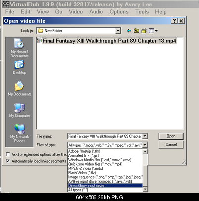

  6. hmm i've installed the latest ffdshow, but it doesn't make the h264 play in Vdub ....
    i've downloaded http://www.youtube.com/watch?v=3yO1vD87aRg at 720p.
    i then got some file, which does LOAD in vdub, and I can see it running, but the picture is black and there's no sound.
    vdub doesn't show the file info, but VLC says it's a AVC1-mp4a file.

  7. In my experience the Quicktime source plugin for VirtualDub doesn't work well. Try forcing the DirectShow plugin instead:
    If you don't have the DirectShow source plugin, get it.
