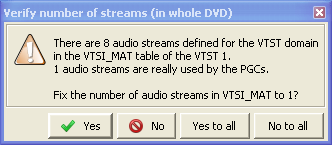

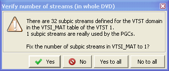

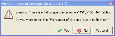

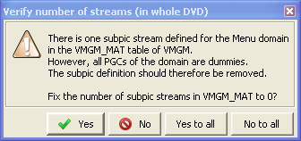

    Below you find some warnings I got when I open the DVD:
Size:  9.0 KBName:  warn3.png
Size:  9.7 KBName:  warn2.png
Size:  10.2 KBName:  warn4.png
    I clicked YES for all.
