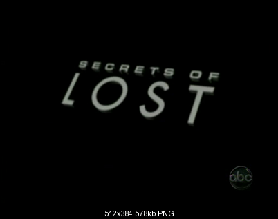

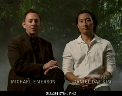

  5. Originally Posted by bat999 View Post
    The small clip plays with mPlayer in Linux.
    It's impressive that mplayer can play such a damaged file.
    Hi
    The other one won't open for me.
    [Attachment 3512 - Click to enlarge]
    [Attachment 3513 - Click to enlarge]

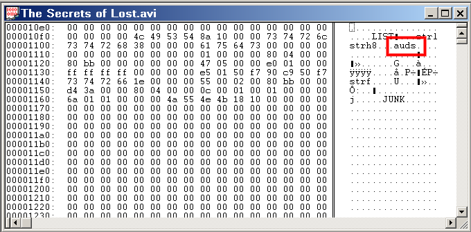

    Actually, there is an audio track. You can see it in a hex dump. But MediaInfo is unable to detect it.
    These files probably can be fixed with a hex editor but it will take someone who knows the structure of AVI files well and has the time and inclination.

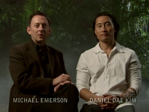

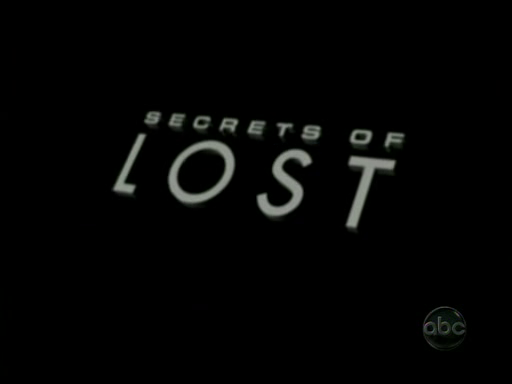

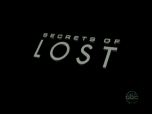

    After patching part of the headers and using VirtualDub to remux "The Secrets of Lost.AVI":

  10. I managed to get the other file fixed too. But the first GOP is messed up (hardly matters, it's all black frames).
