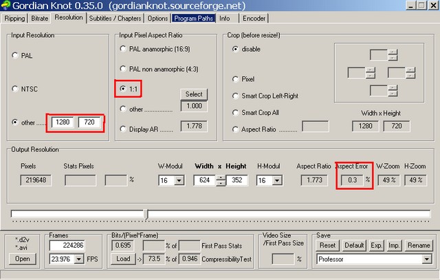

  6. Originally Posted by kkiller23 View Post
    I just tried doing another xvid copy again, but under "input AR i put 4:3 and used the res 640x384 and the ar looked pretty close
    Close, but no cigar.
    You're not using GKnot? You said in your first post you had been using it previously. Whatever AR calc you're using, can't you plug in 1:1? If not it might be better for you to go back to using GKnot for this. If you wish to use other resolutions, you may have to do some additional cropping of height or width to keep the aspect error down:

  8. How do you come up with these resolutions? 608/368=1.65:1. Your source is 1.78:1. You're using 4:3 again.
    Look, unlike DVDs which are always 4:3 or 16:9, these MKVs from blu-ray sources are often 1:1. 1280x720, or 1920x1080. And even if there are black bars that have been cropped away to make them, for example, 1280x544 (2.35:1), they're still 1:1. The Input PAR for the likes of GKnot is 1:1. They don't get resized the way a DVD does, but only scaled.
    If i change the res anymore the AR goes to 0.8,
    You can use any (Mod16) width you like. You might have to do a small bit of cropping to keep the AR Error down, though.

  10. I know that the GKnot default is 32/16, but I changed the W-Modul to 16 because it opens up more resolutions to use. For Xvids that's fine. So, even after you go back to doing DVDs, 16/16 is okay. To tell you the truth, I'm not nearly as familiar with MKVs as I am with DVDs. I don't download that stuff. But the ones with which I'm familiar have all been 1:1, the ones made from blu-ray movies. Others with more knowledge and experience with them can confirm or disagree.
    It's kind of hard to go wrong when using GKnot, as long as you get the Input PAR correct. For DVDs, just pay attention to whether it's 4:3 or 16:9 when making the D2V project file. Then when opening the D2V in GKnot the correct PAR should be ticked automatically. Is there a tutorial? None that I know of. Maybe someone else can provide a link to better explain things to you. Good luck.
