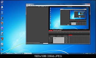

  5. Click image for larger version
    This is a screenshot taken with 8800GTS and the Blackmagic intensity pro installed into a same machine and connected with each other using a HDMI to DVI converter (this is just for testing, I wanted to get it working with my 4870x2 but it just wont work). I set the 2 output to clone mode and got it working with 1080p 30 setting with media express, I have no idea how it worked and I m really confused now.
