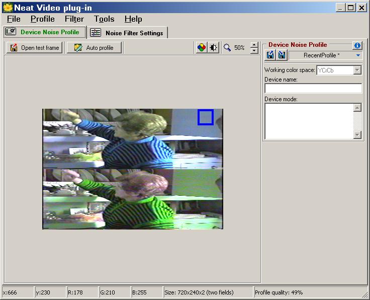

  4. So, the only reason in my case you deinterlaced is that the chroma channels were messed up. Otherwise, you would just first resize and crop and perhaps apply the neat video filter second right?
    As far as interlaced status identification, per your advise, I did advance through the frames using the "Bob Doubler - TFF" filter and, like I said, to me every frame was different from the previous, not 2 frames were near the same. With BFF though, it gave me a back and forth movement.
    Could you please post the neat video configuration settings and direct me on using the Avisynth with the script you used?
    How do I start this thing?

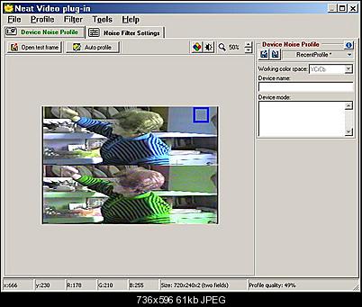

    I don't remember exactly what settings I used and it's not really possible to post them exactly anyway. Part of the process is to give Neat Video a sample that's supposed to be a flat area so it can identify the nature of the noise. Locate a frame with a large flat area and use the Auto Profile option. Neat video should draw a blue box where it finds a suitable part of the frame to sample:
    If you don't like you area it picks, mark a box yourself. For example, in that sample image the bottom field has much more noise than the top field*. It might be better to sample that field instead. You can drag the blue box down to the bottom field or mark an area yourself.
    If the video is interlaced be sure the interlaced option is selected on the main Neat Video dialog. The Temporal Filter setting helps get rid of noise from frame to frame. If you set it too high small details will get lost when there is motion -- for example a fuzzy wool sweater may look like smooth silk.

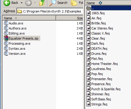

  8. Should this be extracted in this folder?
  9. http://avisynth.org/mediawiki/SuperEQ
    SuperEq("C:\Equalizer Presets\Loudness.feq")
    Put them wherever you want. Use the full path in the SuperEq() call.
