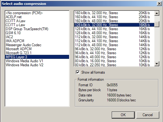

  2. Using Target Quantizer mode in Xvid will get you variable sizes depending on the video being compressed. If you want a fixed size use Single Pass Target Bitrate mode. Xvid isn't really a good choice for video capture. It's too CPU intensive for good compression in realtime.
    In the MP3 encoder turn off Show All Formats. Then pick the bitrate you want to use.

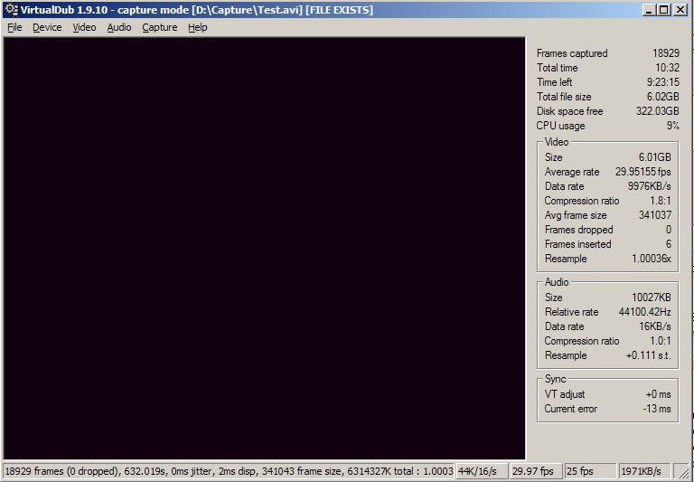

  7. I used HuffYUV and uncompressed audio 44100 and the resulting 10 min test was a HUGE 5.5 Gb file! I have 400 GB on one HDD and another 400 Gb on a second HDD. Should I procced or something is wrong? I hope virtualdub and XVid will be able to process this giant.
    I prefer to set a timer and let the whole tape run rather than sit there, determine chunks, edit, etc etc..
    Just for the final file I would like it to fit on a DL DVD (8gb right?) (assuming the quality is good).
  8. Originally Posted by drgt View Post
    That sounds about right. 30 to 40 GB/hr for SD material. You should capture to a drive that's not your boot drive.

  9. Ooops! The file with HuffYUV and pcm 44100 shows shorter duration than recorded and the audio plays fast .
    At the end when I tried to close virtualdub, it crashed. I chose YUY2 data format is that ok?
    That's often the symptom you get with dropped frames.

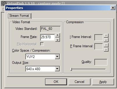

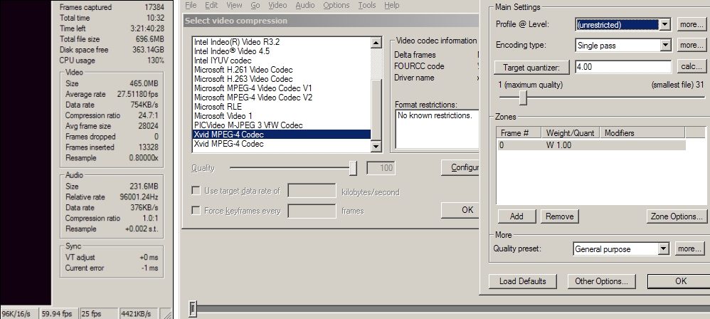

  13. ok. At 720 x 576, I do not even get a good live feed. The previous test was done at 720 x 480.
    Now for this test:
    Done at 640 x 480. For some reason it would not accept 48khz, so I left it at 44100hz. Changed the speed to 29.97. The resulting file reports correct duration. The audio plays normally but after the 1st half starts loosing sync.
    Just like an english speaking Japanese movie!!!
    It reports frames inserted. Take a look at the screenshot.
    The system is core duo at 2.4 with 2gb ram running xp media center sp2. 2 1tb disks.
    I want to thank all of you for your input.
    Now what? Try smaller frame? PAL type or NTSC? (Because what I just made is PAL with NTSC speed!)
    Although I am not there yet, when I process this for the final file I will choose PAL 25fps? I am confused.
    Jagabo, what exactly should I tweak in Capture timing?

  14. Originally Posted by drgt View Post
    ok. At 720 x 576, I do not even get a good live feed. The previous test was done at 720 x 480...
    PAL60 is has NTSC timing but PAL format chroma channels. So you capture with a 720x480 frame, 29.97 fps.

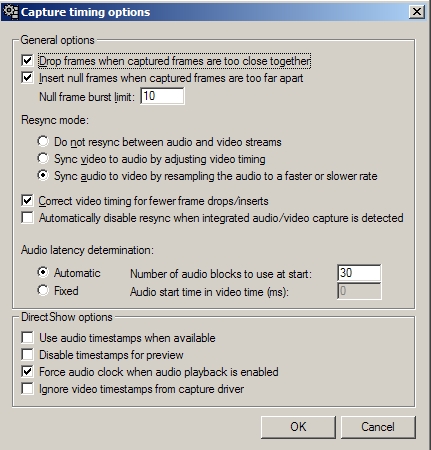

    Try all three "resync" options, especially "Do not resync between audio and video streams".
    Tried all 3 but could not get rid of the "Japanese" effect. Only choice 2 gave me 1 frame inserted.
    Anything else before I give up? (By the way all 3 tries were done at 720 x 480, 29.97fps).

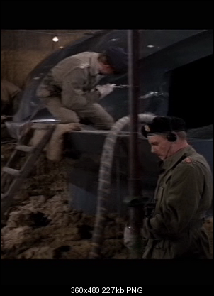

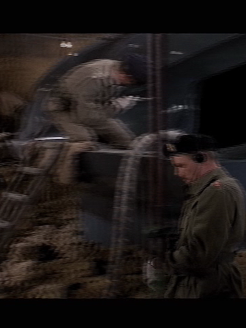

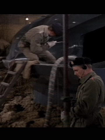

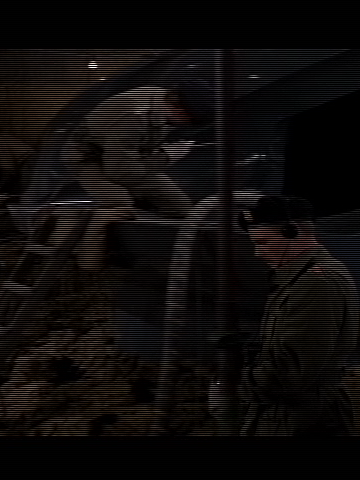

    Interlaced? I do not know but probably not. See G-Spot (test.avi). How do I know the original film frame?
    The easiest thing is probably to encode it as 720x480, 29.97 fps, interlaced MPEG 2, even though you aren't planning on makeing DVDs. Most players will play interlaced DVD properly on a PC or standalone media player.
    MPEG2 you say eh? Won't the mpeg file be larger than an XVid file?
    How do I make mpeg file? VirtualDub supports it?

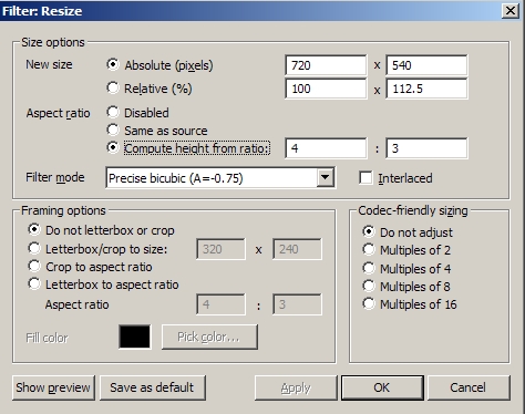

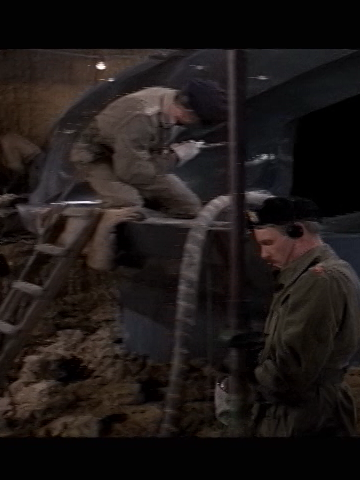

    Anyway, I tried the XVid codec at target quantizer 4.0, resizing to 720 x 540 and adding filter "field bob - smooth" (this last one came from http://www.halo3forum.com/montage-video-help/259024-how-i-capture-pal-60-a.html). The resulting file "test_XVid720x540&Smooth.avi" I burned on a cd and plays fine on the dvd player.
    See G-Spot Screenshot (test_XVid720x540&Smooth.avi).
    So much the above guy as well as this http://www.divx-digest.com/articles/vhs_capture_page1.html (section "THE SUGGESTED SOLUTION") recommend deinterlacing but I did not try it because it was not "Top" choice like the 1st guy said, (see screenshot).
    Take also a look at the resize filter choices I used as I do not quite understand the meaning of "Absolute vs Relative", "filter mode", whether "interlaced" should be checked etc.
    If you want more smaller files you can reduce the frame size to 352x480 (VHS doesn't really have much more than 352x480 resolution so you're not losing anything by using the smaller frame size). That will ~double the amount of time you can get per GB.
    Tell me if you agree with the 2nd guy above in the section "THE VHS RESOLUTION".
    Is there any correlation between frame size and aspect ratio? In other words is this thinking right?:
    "I have a wide TV so I will make my final resolution a multiple of 16:9, i.e 720 x 405 OR I have a letterbox TV, so I will make it a multiple of 4:3, i.e 720 x 540".

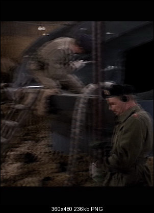

  18. With codecs that support aspect ratio flags any frame size can be used for any display aspect ratio.
    https://forum.videohelp.com/threads/322346-same-resolution-but-difference-in-display-w-...=1#post1995959
    Codecs without aspect ratio flags are usually assumed to be square pixel (PAR = 1:1) by media players -- so the frame size ratio matches the display aspect ratio. Xvid supports both DAR and PAR flags but some players won't respect the flags and assume square pixel.
    NTSC VHS has an effective resolution around 352x480. If you want to use Xvid with square pixel encoding I recommend you use 640x480. If you capture at 720x480 use the Precise Bilinear option in VirtualDub's resize filter. Using a sharper filter (like Precise Bicubic or Lanczos3 will only accentuate the VHS noise and require more bitrate).

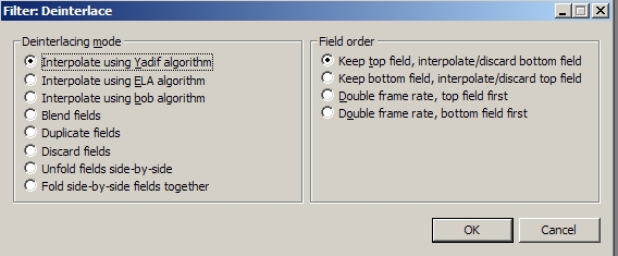

    Deinterlacing is a big subject. VirtualDub's Field Bob - Smooth gives very blurry results when there is significant motion. Yadif (in one of your pictures) is usually much better. If you deinterlace a telecined movie you will end up with a duplicate in every five frames (eg: 1,2,3,4,4,5,6,7,8,8...). This will have a noticeable small jerk several times a second. An inverse telecine will give better results. VirtualDub's IVTC is ok, but not great.
    Attached is a short film clip with VirtualDub's IVTC with the Reduce Frame Rate (resulting in 23.977 fps) and another with the Decomb Only option (29.97 fps, duplicate frames). Notice how the latter jerks several times a second.

    And you recommend deinterlacing using "Yadif" (What about the right side options?) over "Blend Fields"?
    I recommend you leave it interlaced and use a compression codec that supports interlaced video well. That would be MPEG 2. Xvid supports interlaced encoding but some players don't handle it properly. MPEG 2 is safer, though you won't get as much compression. Deinterlacing always reduces quality.
    I 'll make another run using your resize suggestion. Although the burned test is satisfactory to me, if it results in a smaller file with the same quality, it is preferred.
    If you must deinterlace, try the Yadif option in VirtualDub and resize to 640x480. Try Yadif with the double frame rate option -- see if your player supports that (many won't). The single frame rate option is safer but will not play as smoothly.

    If you must deinterlace, try the Yadif option in VirtualDub and resize to 640x480. Try Yadif with the double frame rate option...
    Top field first or bottom?
    It depends on whether your source is TFF or BFF. You can tell with VirtualDub. Apply only the Bob Doubler filter (either TFF or BFF) and step through a motion sequence. If motion is smooth you guessed right. If motion has a two-steps-forward-one-step-back cadence you guessed wrong. If every pair of frames is (nearly) the same you have progressive video. If you see repeats with an aaabbcccddeeeff (3,2 repeats) cadence you have telelcined film.

    3. Take also a look at the resize filter choices I used as I do not quite understand the meaning of "Absolute vs Relative", "filter mode", whether "interlaced" should be checked etc.
    Absolute means "no matter what the source frame size is make the frame THIS size". Relative means "make the frame THIS PERCENT of the source frame size". This can matter when moving filters up or down the list (other filters may also change the frame size) or when using the same filter chain with different source files.
  23. Applied the Bob Doubler filter and previewed. Using TFF and deinterlacing method "Bob", advancing through the frames is smooth. NOT 2 FRAMES ARE THE SAME. (Using BFF, it goes back and forth).
    1. So, still try the Yadif, double Top?

    3. In filter "Resize" where can I find some explanation of the filter modes? AND the box "interlaced" refers to the source or the target?

  24. Originally Posted by drgt View Post
    If you insist on damaging your video by deinterlacing (as opposed to saving as interlaced video), yes.
    Each frame of interlaced video contains two half pictures. One half picture is in all the even scanlines, the other in all the odd scanlines. They are inteded to be viewed separately, in sequence. Here's a crop from an interlaced Frame:
    Here's what Field Bob - Smooth does to it (notice the double exposure look):
    Deinterlace, Yadif, double rate turns it into two frames:
ID:	3584 Click image for larger version
    Unfortunately, Yadif also produces some artifacts on horizontal edges. You'll notice them if you flip through frames in VirtualDub.
    I don't know where you can find an explanation. Basically, bilinear reduces nosie and does not sharpen. Bicubic is sharper but enhances noise (the higher the "A" value the sharper the result) and can create oversharpening artifacts at sharp edges. Lanczos3 is even sharper. I wouldn't use the plain Bilinear or Bicubic in VirtualDub, always use the Precise versions, they generate less artifacts.
    The interlaced option refers to the state of the video at that point in the filter chain. If you applied a deinterlace filter before resizing it is not interlaced at that point.

  25. Originally Posted by jagabo View Post
    I am in no position to insist. Only experts can do that and surely I am not one!! Just regurgitating the info I quoted in previous post.
    As far as your posted examples, I do not see any difference between original and field bob - smooth. They both look double exposed to me. For example, the guy with the beret has "2 noses" in both pictures.
    Hmmm... Certainly did NOT deinterlace before I used the resize filter. That means the box should have been checked. I did not know and proceeded with unchecked.

  26. Originally Posted by drgt View Post
    In the "original" image I posted you are seeing both fields (half images) at the same time. When viewed in a media player (or on TV) you are NOT supposed to see both fields at the same time. You are supposed to see one field at a time. Here are the two fields peeled apart and displayed side by side:
ID:	3587Click image for larger version
    VirtualDub shows you both fields because that's what's in the stored frame. It shows you the true state of the source video frames, not something that's been processed for display.
    If you used Field Bob - Smooth before resizing you deinterlaced.

  27. Originally Posted by jagabo View Post
    No, used Field Bob after resizing, so the "Interlaced" box should have been checked; right?
    Yes. But it's best to deinterlace before resizing.
