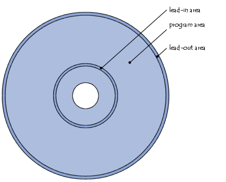

    All DVD discs, recordable or not, must have three basic areas recorded on them: lead-in, user data and lead-out. The lead-in and lead-out areas are boundaries that indicate to a playback device where the inner and outer limits of a recording are respectively. They contain no user accessible information, but are critical to the proper functioning of a disc. The basic recording process is similar to that employed by CD-R technology.
    http://www.pctechguide.com/34DVD_DVD-R.htm
