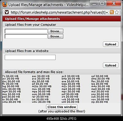

  9. Member edDV's Avatar
    Mar 2004
    Northern California, USA
    You can upload up to 30 MB here, or use a third party posting site.
