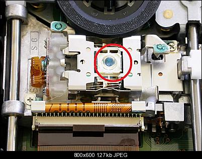

    You could try cleaning the laser lens, but with that old of burner, other parts may be worn. A foam tip Q-tip lightly saturated with 99% isopropyl alcohol should work. Regular cotton Q-tips may leave fibers. You may have to remove the cover from the drive to access the laser lens. They look like this:
