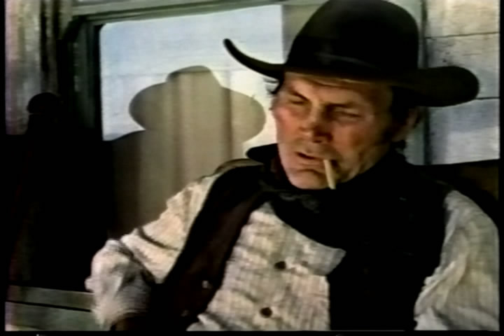

    I do not use either vdub or avisynth. But just to illustrate my previous point I put your clip through procoder. Did not touch the frame-rate just reduced contrast by approx 10% and applied a default temporal noise reduction.
    This was the result - single frame grab:
    (like I said, this 'improvement' may not be to your taste.

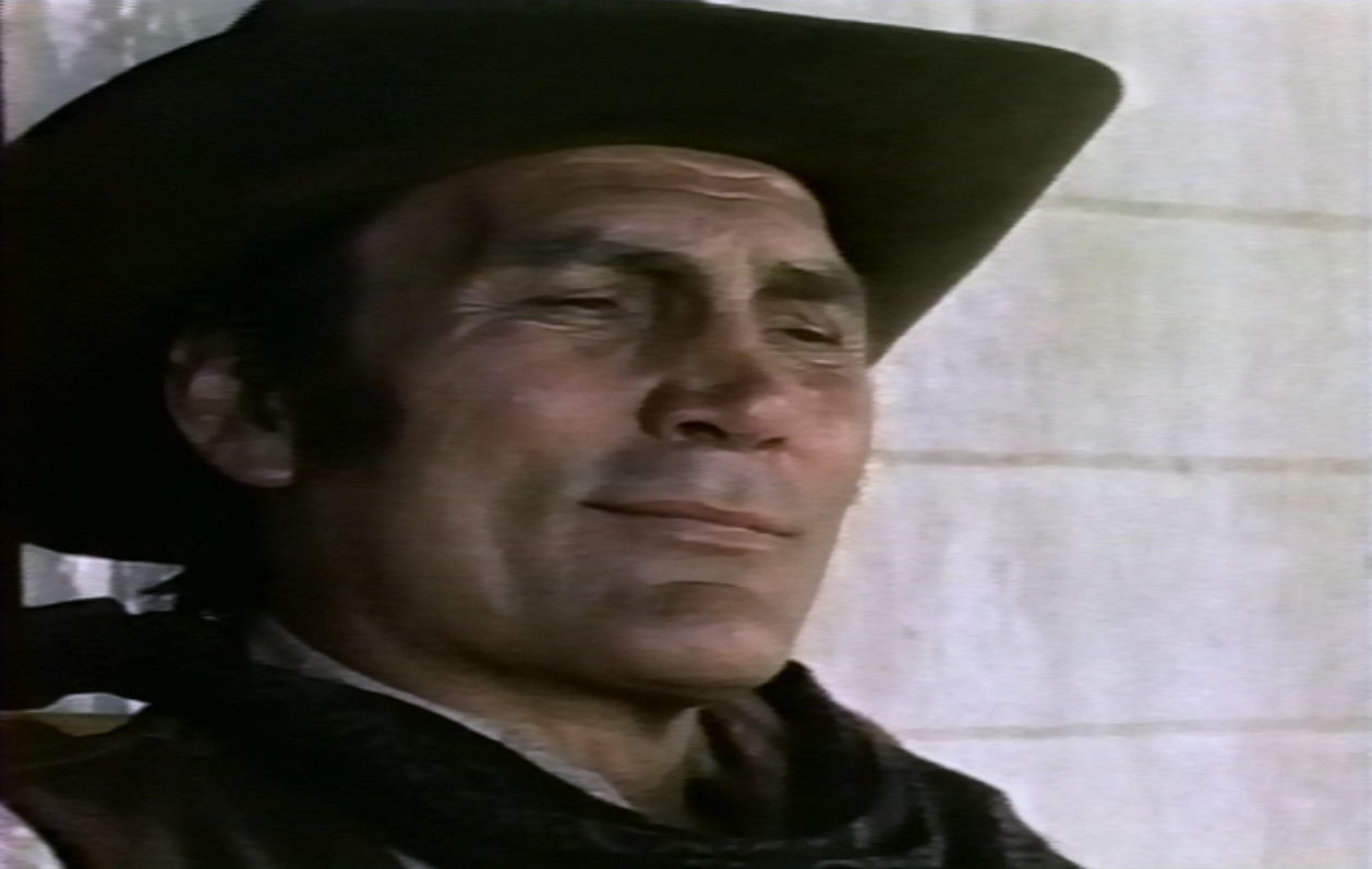

  10. Played around with the filters in Virtualdub some more and got the video to where I am more comfortable with the 'quality' and look of it.
    This time the filter chain is: IVTC, DotCrawl, Contrast lowered 13% (thanks DB83 for showing me the effects of that on this video) and Color Equalizer but with a hint of green thrown back in to correct the magenta that was creeping in. Here is the result.
    In my head I am hoping for a dramatic improvement, but I realize that the source is just crummy; dirty, unsharp and off color.
    What I have managed to do (at least to my eye) is clean up the a good deal of the noise, soften the pallet and correct the color to where the skies are not yellow and the whites are no longer green.
    I'll check it out on my TV tonight, and see if it's time to put it rest. Thanks for following along.

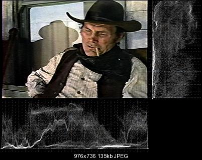

  11. You need to start with recapturing the video. You have crushed blacks and blown out whites:
    In all likelihood there were excursions below y=16 (note the flat bottoms on a graph) and y>235 (note the flat tops) and your capture process cut them off (to keep all pixels in the valid 16<y<235 region.
    The best way to adjust your capture levels is to use a capture graph and pipeline the video to an AviSynth script to the VideoScope() or Histogram() filters. You can then use the capture devices proc amp to adjust levels with immediate visual feedback. I've done this with my AVI 650 USB2.

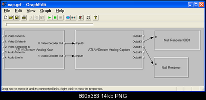

  13. Originally Posted by Des View Post
    Will I still be using virtualdub for the capture from the card or is this done via another method to pipeline out to the histogram filter?
    You would use the histogram filter just to adjust the proc amp settings of the ATI 650. It looks like I was wrong about using a graphedit filter to capture from the 650 and pipeline to AviSynth. I was unable to duplicate that last night. The problem is that the ATI capture filter has several outputs and importing the filter graph into AviSynth with DirectShowSource() requires that only one output be available. Normally you can route the other outputs to the null renderer in the graph but some of the output pins on the ATI capture filter aren't accepted by the null renderer:
    Output2 is the video output. Output3 and Output4 are routed to null renderers (one is audio, the other MPEG audio and video). Output5 and Output6 can't be routed to the null renderer (I don't know what they are). DirectShowSource("cap.grf") complains about there being more than one output pin in the graph.

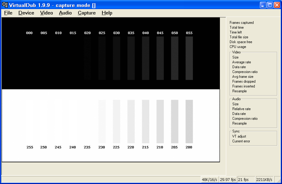

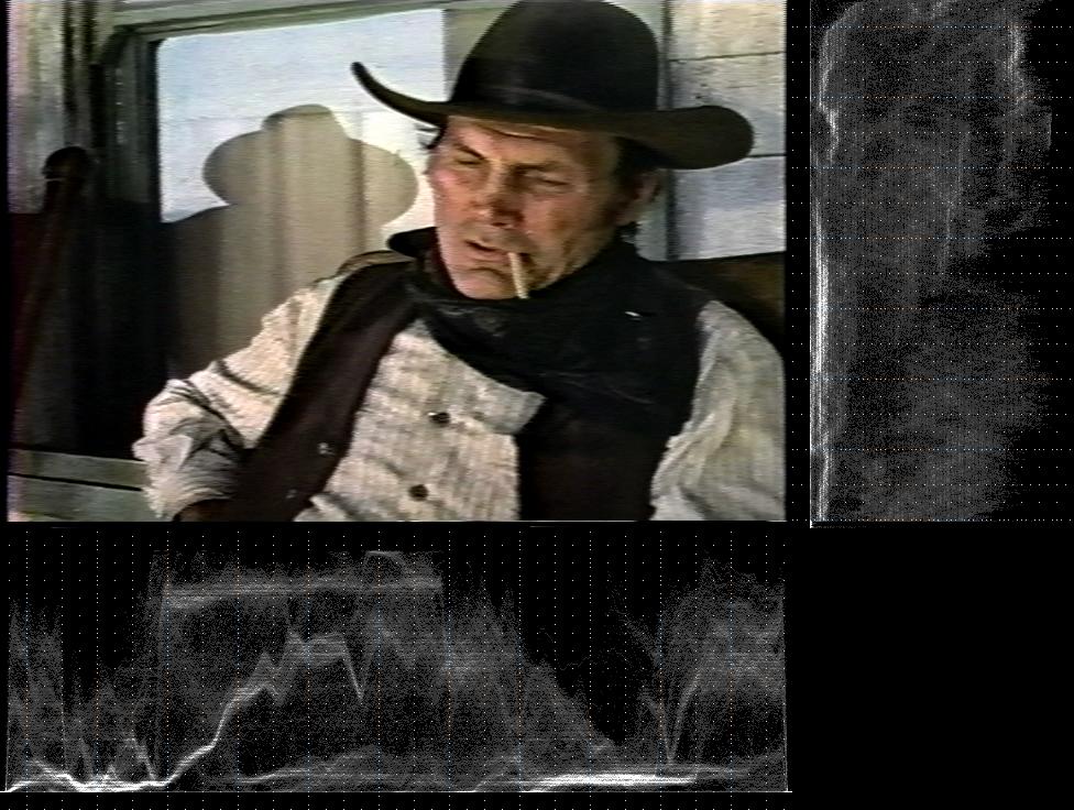

    The ColorTools filter in Wave Form Monitor mode works well too. You have to enable the Filter Chain in VirtualDub then add ColorTools:
    A levels video cap (keep in mind that VirtualDub performs a rec.601 luma expansion so superblacks and superwhites are crushed):
    And the ColorTools waveform (before the rec.601 luma expansion):
    The waveform graph has dashed lines at Y=16 and Y=235 but you can't see them in this picture because the bright white lines (from the background) are right on top of them.

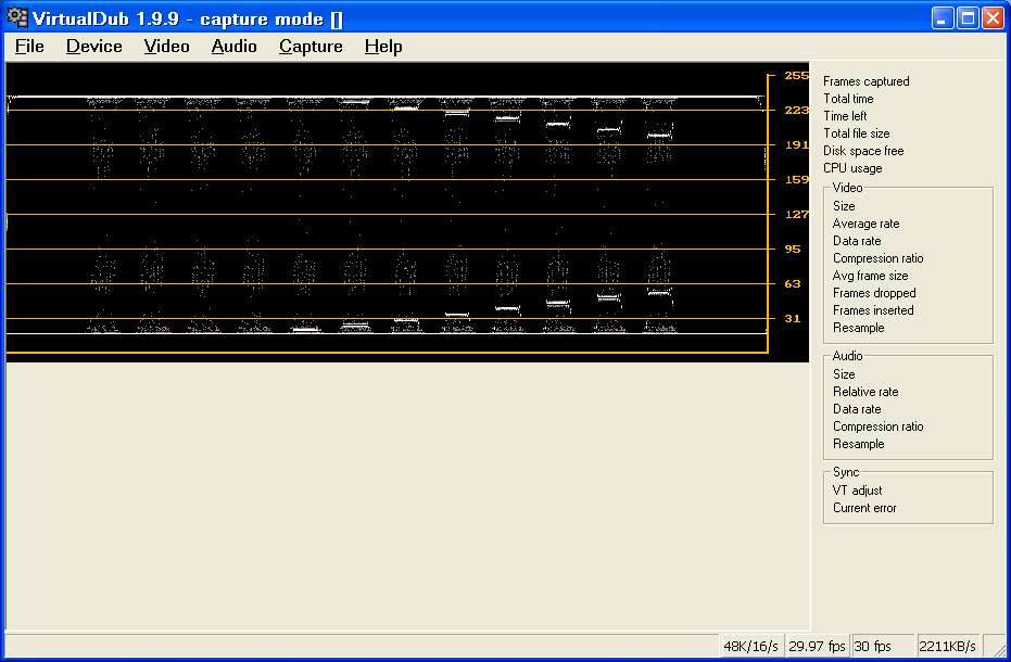

  16. I started playing with the capture settings in Virtualdub last night, and have discovered as Jagabo mentions, that the levels command is not available to the ati 650. Also the process amp settings for the card are grayed out as well.
    The histogram does come on and is active if I have overlay off and preview on, but I cannot seem to adjust the capture level.
    Extend black range and extend white range does 'something' in the histogram but I can't see the difference in the video. I am guessing they just give more latitude to the histogram.
    This is the 650 pci-e version, but I doubt it's really any different than the usb version.

  17. Originally Posted by Des View Post
    So when you select Video -> Capture Filter, then select the Video Proc Amp tab you can't move the sliders?
    Have you tried using GraphEdit, adding the ATI capture device, and adjusting the proc amp there? (The images in my previous post were made using the ATI 650 USB2, adjusting the levels in GraphEdit.)
    You want to leave those disabled.

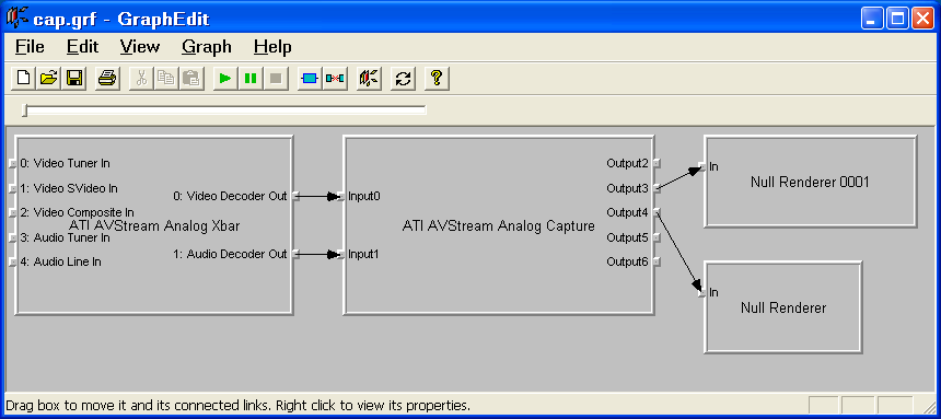

  19. Originally Posted by Des View Post
    I will try that this evening. I used to use graphedit a long time ago, will need to play a little to refresh my memory.
    For this purpose it's very easy. Just start GraphEdit, Select Graph -> Insert Filters, expand the Video Capture Sources tree, and add the ATI analog video capture device. Back at GraphEdit's main window right click on the capture filter and select properties, then go to the Video Proc Amp tab...

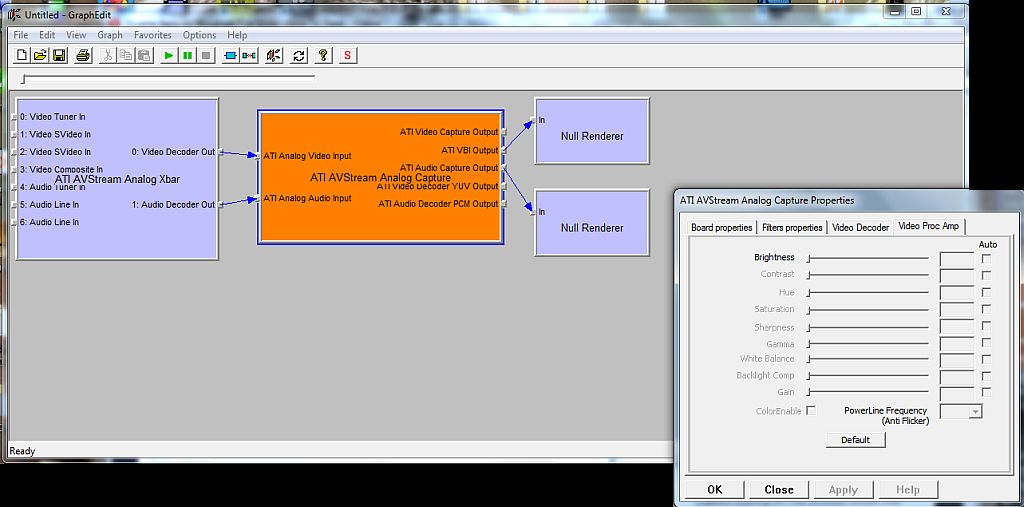

  21. I managed to use graphedit to create the ...graph?
    But I still have no control of the processing amp:
    Lodovico wrote:
    Are you using Windows 7, by any chance? I found that the Proc Amp controls of all my capture devices stopped working when I installed Windows 7. I now capture on a separate partition running XP.
    Yes, I am using W7 along with the 'latest' Ati drivers for W7. I was wondering if having Aero turned on could be the problem, but disabling it seems to have no effect.
    Do you dual boot or with XP, or run it in a virtual machine? I would prefer a VM because I'm lazy But I could set up a dual boot.

  24. Originally Posted by jagabo View Post
    Try capturing without the AVT-8710. I've noticed it tends to blow out the whites.
    Darryl
  25. Darry
    Unfortunately I can't the AVT-8710 corrects keeps the ati 650 from flagging the macrovision.
    I need to take a day or two off from this to do 'real work' and rethink my set up.
    --dES
    "You can observe a lot by watching." - Yogi Bera
    http://www.areturningadultstudent.com
  26. Damn you, Macrovision!
    Darryl
