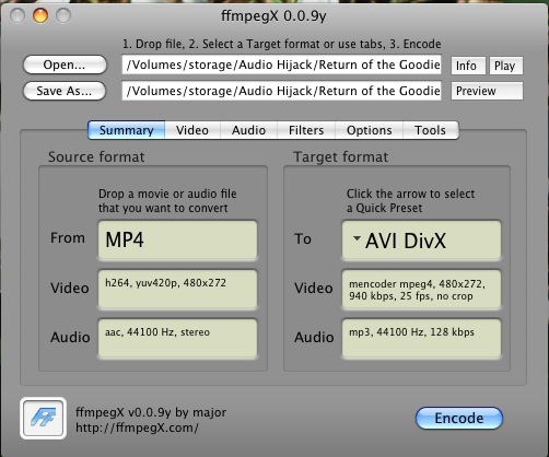

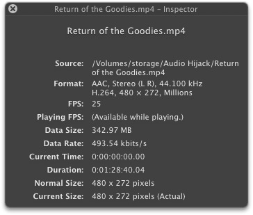

    Now although this says the audio stream does not exist, the mp4 will play quite happily in Quicktime (with sound)
    I have attached the quicktime window and the ffmegx window if that is any help.

    Dec 2010
    London
    Dear Case
    Thank you for your message. I have tried "Invert Mapping" earlier, but with no results. However do you mean I have to use "Invert Mapping" with the DivX ffmpeg option (see attachment) and that it does not do anything with the DivX mencoder setting. Sorry to be so helpless.
    Many thanks
    dtsrppp

  12. Explorer Case's Avatar
    Feb 2004
    Middle Earth
    Originally Posted by dtsrppp View Post
    Do you mean I have to use "Invert Mapping" with the DivX ffmpeg option (see attachment) and that it does not do anything with the DivX mencoder setting.
    Yes. The stream mapping is an ffmpeg option, so "Invert mapping" doesn't do anything for mencoder conversions.
    The version of ffmpeg in ffmpegX tries to convert the first stream to video and the second stream to audio, unless instructed otherwise. If the first stream is audio and the second stream is video, then ffmpeg may error as it finds a mismatch in the streams.
    It may seem a bit weird to bother the user with these details, but that's how this version ffmpeg worked when it was compiled. (Later versions of ffmpeg can figure it out better by itself, without user interacting, but ffmpegX can't use those newer versions without the developer making changes to ffmpegX.)
    input ----------- output
    #0.0 video --> #0.0 video
    #0.1 audio --> #0.1 audio
    streams match
    #0.0 audio --> #0.0 video
    #0.1 video --> #0.1 audio
    stream mismatch
    #0.1 video --> #0.0 video
    #0.0 audio --> #0.1 audio
    invert mapping

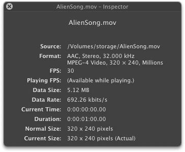

    Many thanks for your message. Just to complicate matters I had a .mov that I wanted to put on my iPod, so I dragged and dropped the .mov . Selected iPod H264 320w (attached). Pressed play - no sound this time (info is attached as well). Should I use invert mapping.? How can I tell which 'to' options are ffmpeg?
    Sorry to be so stupid.

  14. Explorer Case's Avatar
    Feb 2004
    Middle Earth
    Not to worry. You know the audio is there and is good. The [Play] button invokes mplayer to play the source file. If ffmpegX is not using mplayer to decode the file, then this has no consequences for the conversion.
    The reason mplayer will not let you hear audio has to do with stream order and the way in which ffmpegX tells mplayer what to do. Yes, it's a bug in the software. The mplayer binary can play audio from the same file just fine, when used from the Terminal:
