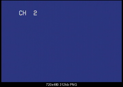

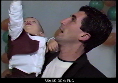

    I'm trying to convert some VHSs to DVD and I'm having a hard time on one of them
    I have my HR-S9800U connected to a Panasonic DMR-ES15 and then a Canopus ADVC110.
    After suffering with dirty video heads (even cleaning the tapes before using them) I can't get a satisfying result.
    What artifacts you guys see on the above screenshots?
    The first one is when the video is not playing, as you can see. But I don't know if those dots and lines are normal.
    Then the video I'm trying to capture, which I set stabilizer ON on the VCR, because the TBC was making it really shaky.
    Any thoughts?

    Moire pattern -- digital noise. I'd bet on it being caused by Canopus box.
    Does it appear on TV?

    But it seems my VCR svideo output is not very good. I reconnected the cable and it seems a little better now. Without the dots and lines.
    This "moire pattern" you say is on both screenshots?

  6. Dot crawl and vertical lines in the flat blue image. Dot crawl comes from not completely separating chroma and luma in the composite signal (either the ADVC110 or the ES15). The vertical lines may be from the source, the ES15 or the ADVC110.
    Chroma noise, luma noise, blurry chroma channels (unavoidable with VHS), a little macroblocking (unavoidable with DV) in the other image.

    Kind of hard to eliminate all that
    But it's acceptable overall.
    Maybe the chroma and luma problem was caused by the svideo output on the VCR. Which is better now. Even the lines on the first image are not seen anymore.
