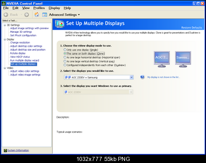

  4. As Nelson37 pointed out your setup has switched from clone mode (same on both monitors) to extended mode (one big desktop spread over two monitors). Switch it back to clone mode with the Nvidia Control Panel:

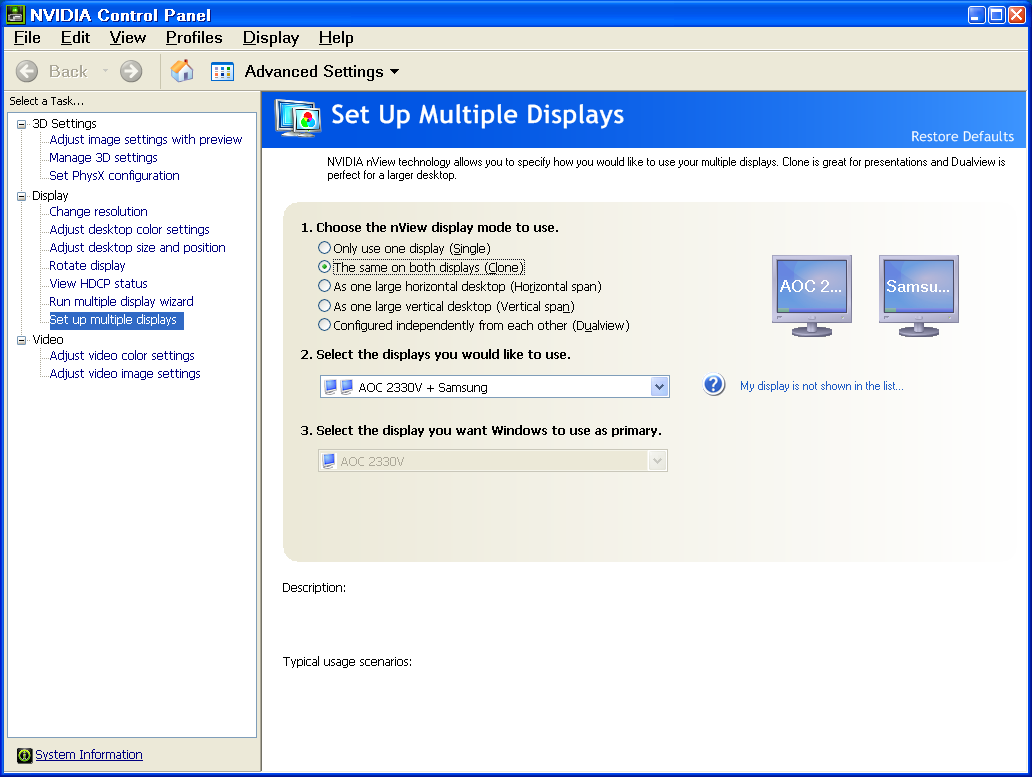

  5. Originally Posted by jagabo View Post
    As Nelson37 pointed out your setup has switched from clone mode (same on both monitors) to extended mode (one big desktop spread over two monitors). Switch it back to clone mode with the Nvidia setup applet.
    Is already cloned ( clone displays)
