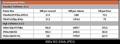

    The BM Intensity needs a RAID for uncompressed HD capture. From their brochure
    Those are MegaBytes per sec. For example 1280x720p/59.94 is 106.8 MB/s or 854 Megabits per second sustained.
    The problem with single drives is speed changes continously across the drive, fast at one end and slow at the other. A RAID zero averages two or more drives to a near constant sustained rate start to finish.
    This Samsung Spinpoint F3 test puts "average write speed of a titanic 96.7MB/sec" which is too close to the edge for reliable 720p capture. You need a viable headroom (25-50%) above 107MB/s.
