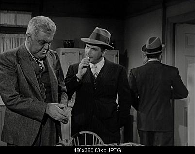

  4. I'll try to up a pic.
  5. Click image for larger version
ID:	3339Click image for larger version

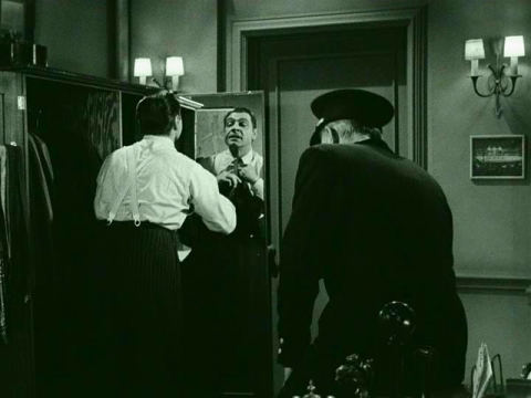

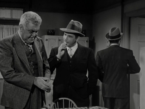

ID:	3340These are two episodes from the SAME "Untouchables" disc which I recently purchased. When played on my LCD tv, computer, whatever, one of the episodes has the green throughout. The second example does not. This is the same look that happens with some B&W .avi files I've created, even if I create them as greyscale. I did turn up the chroma a tiny bit on the first pic to accent the effect, as it's very evident on TV but not as much in a screen capture; it seems to vary with movement.

    A pic would help. If you are talking about a color shift in blacks or whites, that is often the result of an improper YCbCr to RGB conversion, or visa versa. For monochrome, Cb and Cr should settle to nominal leaving only Y.
    In the old analog NTSC days TV stations could force monochrome by killing the color burst on the back porch. TV sets responded by switching off color decoding. The digital equivalent is applying an HSL or HSV filter and forcing chroma saturation S to zero.
