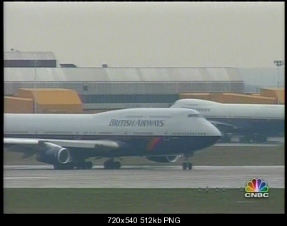

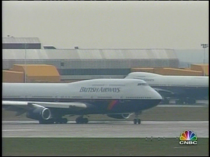

    Overscan masks most of these issues on an actual display so it is hard to see the difference. The most obvious 704 vs 720 issue is with SD analog TV captures. ATSC and DVB broadcast 704 wide but most capture devices capture 720 extending into into blanking. I like this since it gives a 0 IRE reference from blanking. Downside is 8 pixel black stripes left and right.
    Here is an example of the 8 side pixels. Note the H shift right. That happens during A/D capture due to sync issues. The error can build up with repeated A/D D/A. If that frame was 704x480, several columns of pixels would have been shaved off the right side. That was the reason for 720.
    Maybe this wasn't the best example but it illustrates the point.

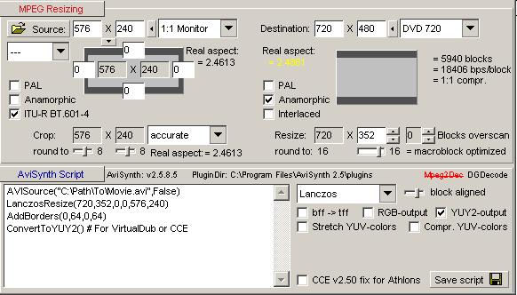

  23. Originally Posted by Krelmaneck View Post
    Let's use the video size of 576 x 240. I know this is a rare case, and a bit impratical, but AVi's could have any size they want.
    Maybe there would not need to really be a vertical stretch for this one either because 240 may be ok. But can you show me an example of where I would need to vertically stretch something and the math to go with it?
    You can make life easier for yourself by letting FitCD do the work for you:
    But better might be:
    Lanczosresize(720,360)
    AddBorders(0,60,0,60)
