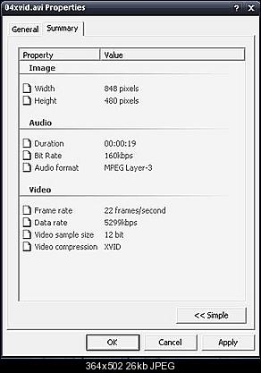

  7. can you recommend a good tool to cut up a small video to post on here as an example, without modifying anything? heres an example from one of my avi files that has no audio, windows and vlc properties fully show audio within the avi :-

    my other avi videos with sound that also dont work in dvd conversion, have "MP43" or "MJPEG/motion JPEG video" showing (instead of the MP4 showing for the video codec, as in the left image above with VLC), but they all have MP3 for audio, at similar bitrates. I think if I uploaded a video, you would have to try a seperate "avi to dvd" program yourself (such as MF7) to notice that the audio does not play at all, in order to try and solve the issue? although I have "solved" the problem by converting some files to WMP instead of AVI (using the same daniusoft conversion program!), I wouldve liked to find out why MF was disliking all daniusoft AVI and preferring daniusoft files only when converted to WMP in order to play the same audio.. very odd! Im not sure why when I convert to XVID AVI it shows XVID MP4, but I have tried editing ".avi" to ".mp4" and its still the same outputted dvd with no sound. It shouldnt matter however, since MF accepts both mp4 and avi for the container format, and xvid for the codec.
