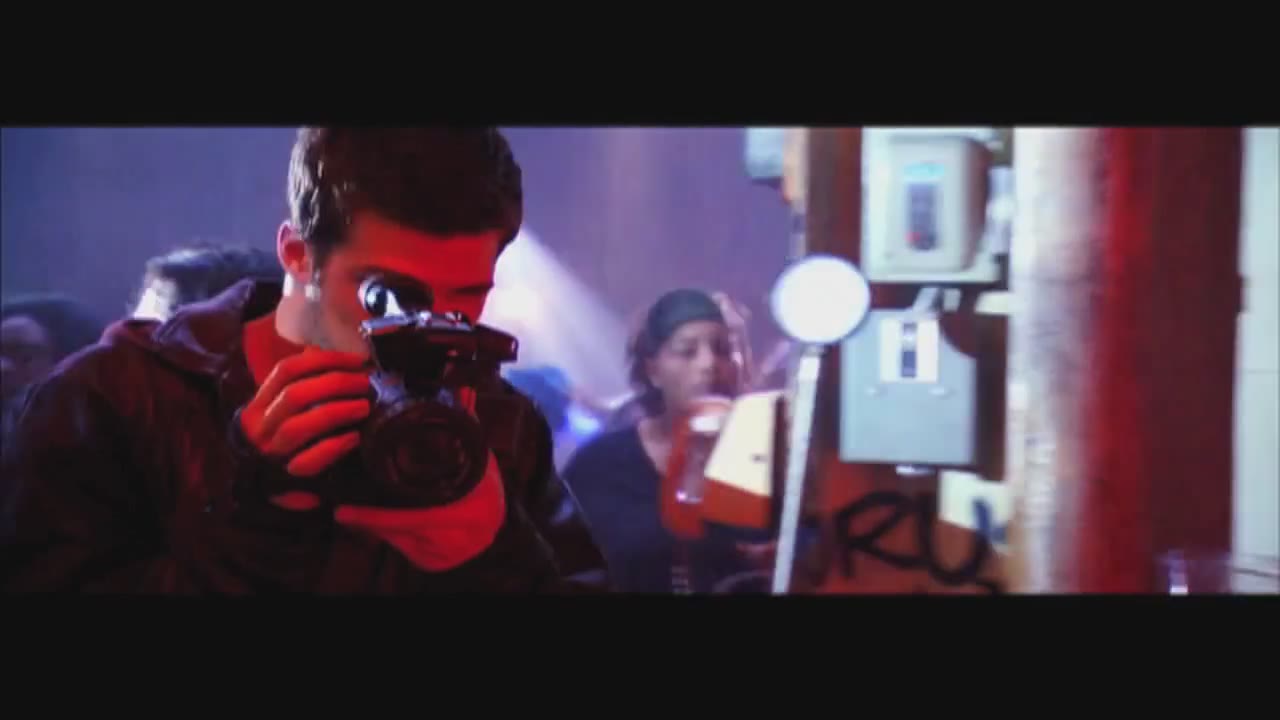

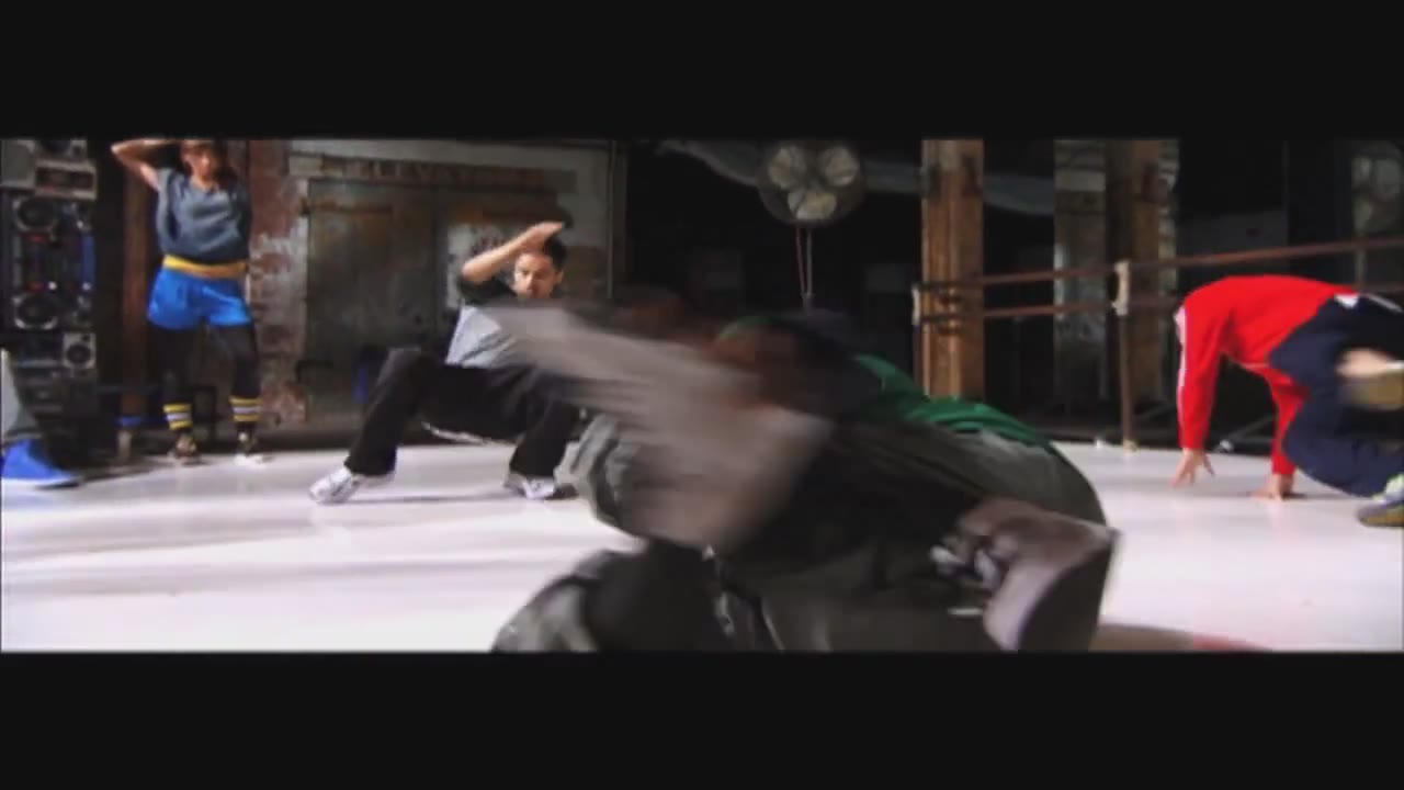

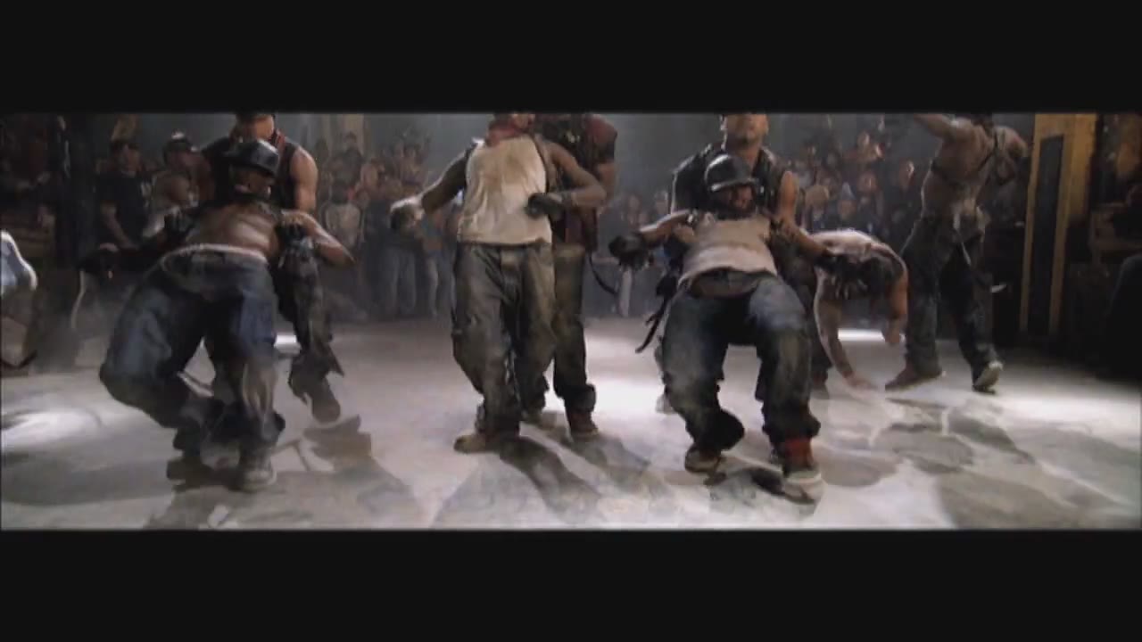

  6. Here they are...
    Just after this... nothing else added yet.
    DSS2("..\Florida.mp4")
    SelectEvery(5,0,1,2,4)
    AssumeFPS(24)
    As you can see there are a lot of macroblocks coming from compression... Even if comes from an Youtube 720p source (more artifacts than other youtube video)
    Another thing... do you think the chain below is correct?
    ManageFPS/interlacing -> DeNoise -> Resize
    Not sure what should come first between denoise and resize

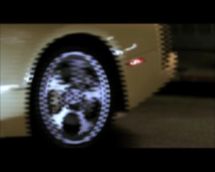

  17. It's subtle because it's resized smaller, but it appears in your sample too, when you bob deinterlace (it will show up when you play in DVD player) . When you single rate deinterlace, 1/2 the fields are thrown out . e.g. play with vlc, activate deinterlace, yadif 2x
    I think you might have did field resize incorrectly (instead of resizing when it's progressive)

  19. Do you not see the problem? I can reproduce it on your mpg sample (and the script for the YT sample) , or playback with vlc yadif x2 mode, or examine it in avisynth
    I'm guessing ChangeFPS is sampling the wrong field. If ChangeFPS were used after TDecimate() (ie. used on frames instead of fields), the problem doesn't occur , but instead you get lots of dupes, but at least field order seems fine after re-interlacing
