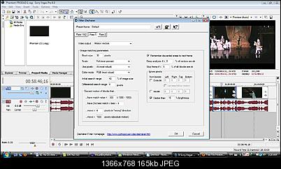

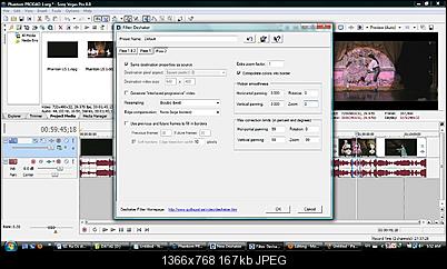

    I tried to use Deshaker to fix it, but the result was just... as shaky.
    Not sure what's wrong with it, here's the settings I used:
    *PASS 1
    *PASS 2

  2. I am by no means an expert on using deshaker, but there 2 things that I am 100% sure of:
    1) deshaker works better with no black borders . You should crop the footage before inputing
    2) deshaker works better with progressive footage. There's pros/cons to deinterlacing, deshaking, then re-interlacing, and the arguments for either side are fairly solid. I will say that if you use a good avisynth deinterlacer, you will get better results overall on most footage
    You havent posted the other settings used pass 1&2 tab (interlaced, aspect ratio etc...)
    Consider using the edge compensation modes , because your "deshaken" video has fairly ugly edges IMO. Deshaker's edge compensation is one of the big features that sets it apart from other stabilizers

    Thanks for the suggestion.
    Yes the edges are ugly :P
    I choose Edge Compensation: None (Large Borders) in Deshaker, because when I'm satisfied with the result, I can use Vegas to crop it later.
    The Fixed Zoom option is not really useful with long clips, the pictures keep zooming in and out

  6. Originally Posted by namphong0612 View Post
    By cropping (and presumably upscaling later to fill the frame size), you are losing active image area - i.e. you're losing pixels
    Deshaker has ability to use information from past & future frames to fill those edge pixels, it's uncheckmarked in your screenshot - but it works well in most cases.
    You can use the adaptive zoom or adaptive + fixed combination. If you use it in vdub, you can preview the result after the analysis pass
    Also, what are your expectations? Deshaker just "smooths" everything over. It's not a stabilizer meant for rigid shots (as if shot on a tripod or locked down shot)
  7. When video has a lot of dark background I find it helps to set Scale to Full, and Use Pixels to All -- it looks like you've used those settings. I would also turn off Detect Zoom and Detect Rotation. I just tried it on your clip and it worked pretty well. As poisondeathray pointed out, at default settings it does not remove the low frequency wandering, just the high frequency shakes. If you crank the Smoothness settings up to 10000 a lot of the wandering will go away.
    Note a new version of DeShaker for VirtualDub was released just a week or two ago.
