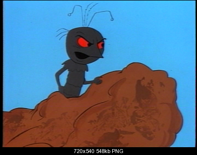

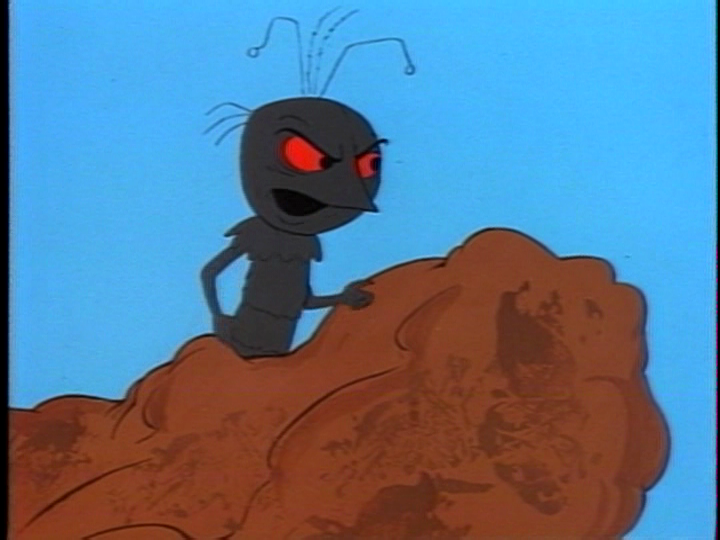

    Originally Posted by henryperu77 View Post
    aedipuss it doesnt matter, thats not a problem.., i can ivtc easily.. the main problem was that annoying vertical artifact.. -_-
    i'm with corny. until it's captured and processed properly there isn't an artifact, just human errors. at this end we can only see what you post.
    anyway, looking at the ant video, it appears to be an old worn second or third generation copy. i see the vertical lines but can't identify a single cause. lots of color shifting from generation loss though.

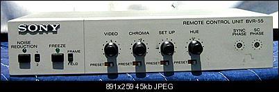

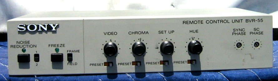

    So, what's your recommendation my friend? what can i do to get a better picture quality from it? even when i have a umatic player with its TBC and DNR board.. I'm just waiting for the external TBC remote control in order to get more features to be configurable and check if that do something on the quality
    this is the remote that i bought
    Hope it helps me to get a better picture quality.

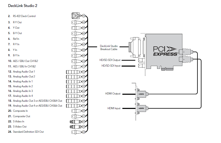

    Hello, the capture card is the Blackmagic Decklink Studio 2.
    As I know this capture card has been used even in professional video jobs.
    The input/output diagram is as follow:
  18. And all that money didn't go into the comb filter.

  20. Originally Posted by jagabo View Post
    Just one extra information, I've already connected to umatic video-out to a Monitor (those one that used in Tv Stations). It was a Sony Monitor, and I even noticed the "vertical lines" on that screen.
    Regards
    Nov 2008
    Finland
    I can confirm that Blackmagic Decklink Studio cards have a very bad comb filter. Also all my professional VTRs which at one time cost more than a car have had crappy filters. Being professional product is not a guarantee of a good comb filter. I got no experience with Sony monitors but there's no compelling reason to assume it's very good either in that regard (if not stated otherwise in the specs).
