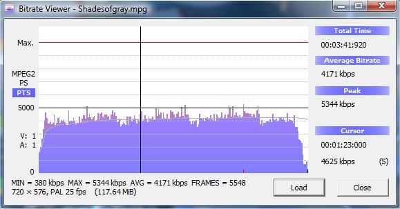

    Here is bitrate viewer results for the video before uploading.
    I start with an avi and wave file then export using adobe media encoder as mpeg2
    pal, 720x576, 25fps ,lower, quality 4.0
    224 kbps, 44.1khz, 16 bit, stereo, mpeg
    VBR, 2 pass, min 2.50, target 4.20, max 6.00 mbps

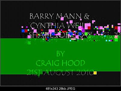

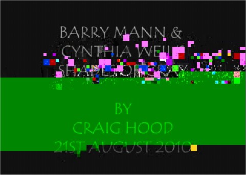

    At 480p the sound is sometimes passable and sometimes has a few glitches/jumps with the video going all pixelly and green.
    Like this :

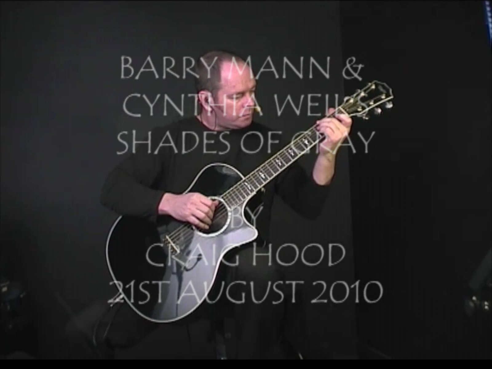

    Yes 1970x1440, for some strange reason, that size uploaded to youtube almost fills the screen with no borders.
    You'd have to show me for me to believe that.
    Jun 2008
    Thanks for that, never new about it.
    I'm viewing on a 21" monitor (not widescreen) at 1600x1200.
    As I said before, the aspect ratio in this video was probably screwed up before uploading (probably something like pal output using ntsc pixel size), hence the unusual resolution.
    Adobe gives you an input and output preview before saving, I adjusted the output resolution to get rid of any borders and ended up with 1970x1440.

    Just uploaded a version that I'm happy enough with for now, but I'll keep researching the sound quality issue as I re-upload my other vids.
    This result is starting with a 799mb dvpal video exported from adobe premiere with the titles added and PCM wav 1411kbps 44100khz audio.
    Then into a great wee program called Ripbot264
    All default settings except :
    save as mkv
    CRF 18
    (in properties) resize to 1440x1080
    deinterlace BFF -> 25fps
    denoise Film
    Colours use TV -> PC conversion
    The 179mb was processed very quickly by youtube.
    Video enhancer made a better job of the upsizing, but so far I haven't got good results with it's deinterlacing filters (will keep experimenting).
    Both 720p and 1080p audio always ended up at 128kbps during all my test uploads with different codecs.
    360p was either 54kbps or 100kbps, with 54kbps sounding bad.
