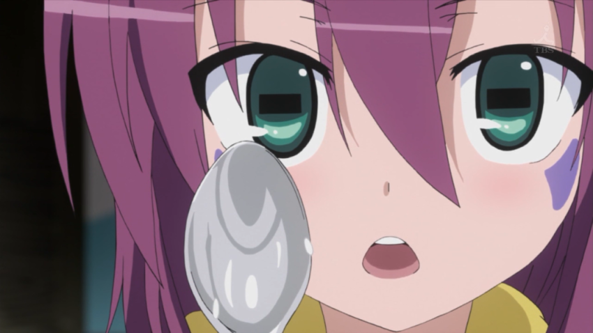

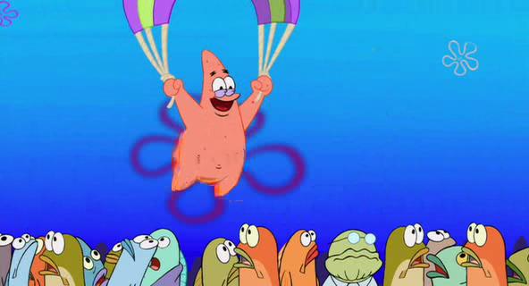

  10. I hope it's not too much of an issue if I'm bumping this thread but I wanted to show you the difference I was talking about and finally was able to make a very easily noticeable comparison:
    http://i224.photobucket.com/albums/dd303/Buu-Huu/ex1.png < What it looked like before.
    http://i224.photobucket.com/albums/dd303/Buu-Huu/ex2.png < What it's after.
    This is the kind of degradation I was talking about the whole time. I should point out that I have a new laptop since yesterday and after copying the videos over from an external HDD, the good quality the videos had on my older laptop "degraded" once I played them on this one. Mind you, I re-downloaded the same video but the result stays the same. So basically it's a "download - good quality > format PC - bad quality" situation. Exactly as on my old machine.
    I'm at a loss as I'm convinced it's not the computer but I can't find the cause in the videos either. Anyone got any ideas?
    By the way, I'm aware that the comparison pics aren't from the same source but it shows exactly what I was referring to with quality loss. Theoretically I could take comparison pics from the same source but I don't want to reinstall my entire OS now. Besides, it would just yield the same result as above so it wouldn't make a difference.

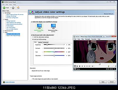

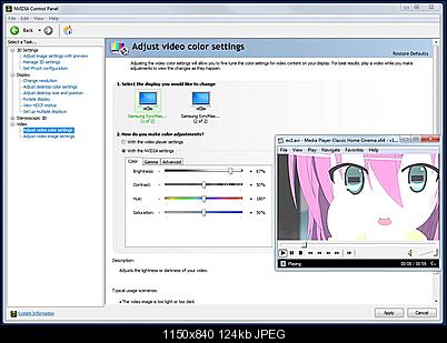

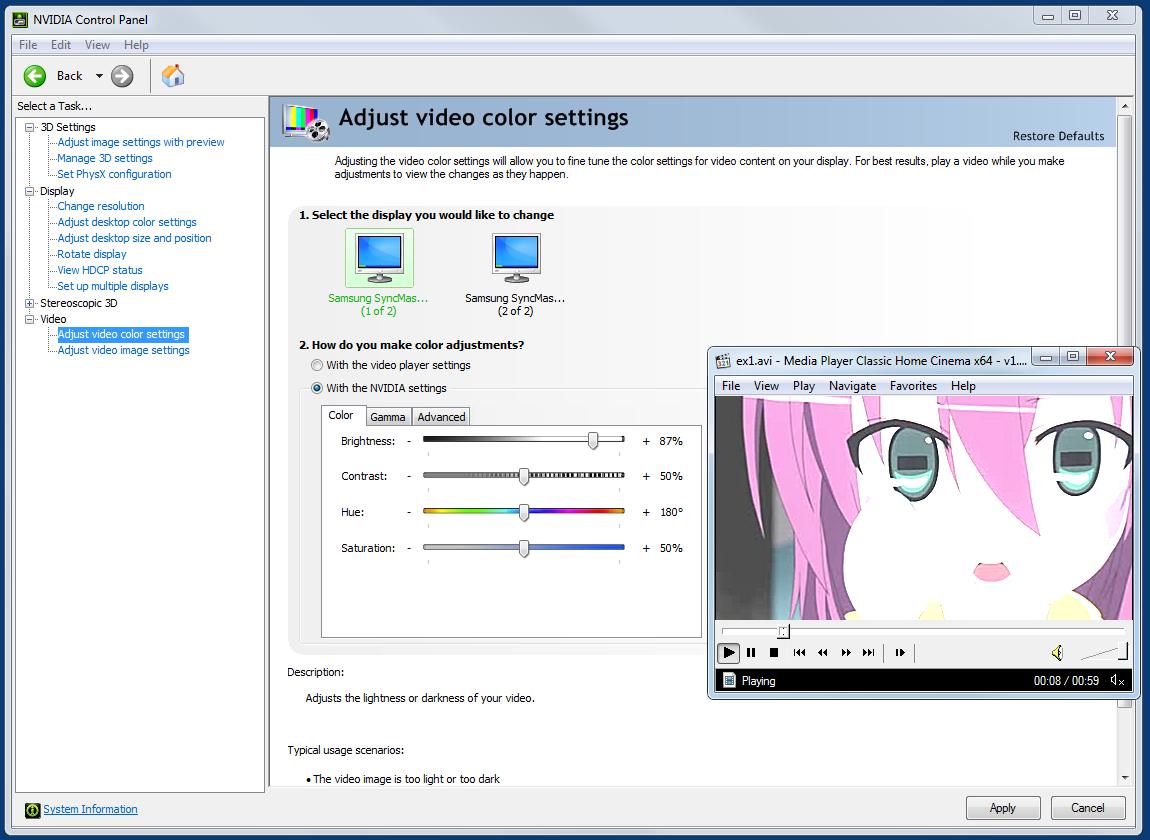

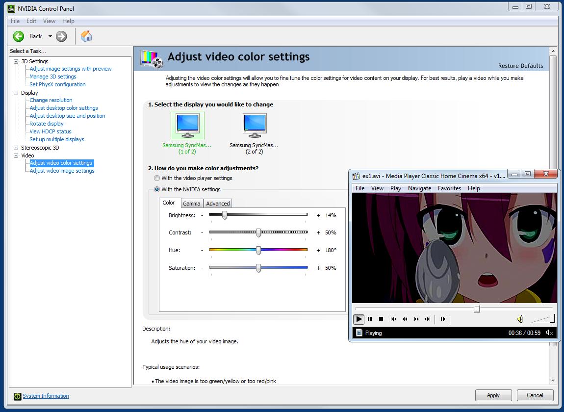

  11. You just need to adjust your graphics card's video proc amp settings. For example:

  12. That makes sense, yeah, but there's still a problem left: Videos I haven't downloaded before come in good quality with vibrant colors. I made this observation on my old laptop.
    Let's say I have three videos. I save them on my external drive (they still keep the good quality) and format my entire machine. Then I copy them over (with the exact same settings I had before the wipe) and they show with lost quality. I download the next episode of the series and it has good quality, just like the older ones before.
    Now wouldn't the adjustments in the graphics card settings darken the good quality videos even more than they already were before while the bad quality ones get their vibrant colors back?
    I hope that made halfway sense. :S

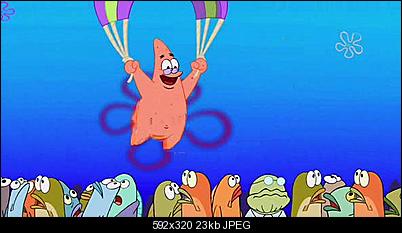

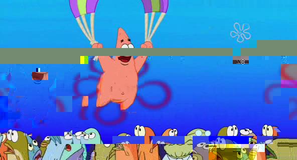

  17. Originally Posted by Buu View Post
    What exactly do you mean with "very obvious blocky artifacts"? It's not only the brightness that changes but also the picture itself becoming more... pixelated. Think of a PNG -> JPG conversion
    No, it's much worse than that. Exactly what you get will depend on the nature of the error but were talking about something like this:
    good:

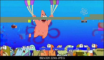

    bad (I manually injected some errors into the video):
    You've probably seen errors like this on occasion when watching TV -- when a digital transmission gets screwed up.
