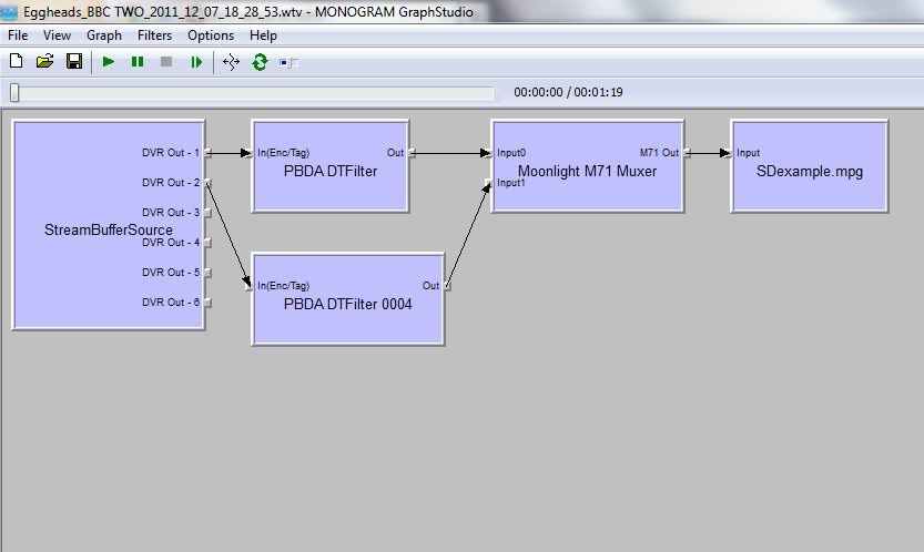

  8. Hi, first post and all, so I'll try my best to be as unannoying as possible.
    Using the extremely helpful method outlined by the OP, I've spent a stressful afternoon attempting to remux UK, Freeview (HD) sourced wtv to mpg. SD recordings are remuxing splendidly; HD is proving a different story.
    I'm using GraphStudio with the Moonlight M71 Muxer (set to Program Stream) and DumpPos. For SD, it's simply a case of deleting the unnecessaries, adding the M71 filter, connecting DVR Out - 1 (audio) to Input 0 and DVR Out - 2 (video) to Input 1 (which automatically generates two additional filters "PBDA DTFilter" and "PBDA DTFilter 0004", respectively). Screengrab:
    However, replace the source file with a wtv containing an HD stream and this happens:
    The DVR Out - 2 video stream will not connect to the M71 filter via the PBDA DTFilter 0001, which, again, is generated upon (attempted) connection. Of course, when GS is instructed to render, the outcome is a mpg with an audio stream but no video.
    I have heard of the difficulties in handling Freeview HD's AAC LATM audio but this appears to be a video stream issue? In my increasing weariness, I may have forgotten something really obvious so I await with blushing emoticon close to hand your no doubt helpful responses.

    Moonlight M71 Muxer is for MPEG-2 video only. If what I read about Freeview HD is true, .wtv files from Freeview HD contain H.264 video, so Moonlight M71 Muxer won't work. Sadly I don't know of a good filter for muxing h.264. You could try writing the audio and video to separate files and use a stand-alone multiplexer.
  10. Ah, well that'll be the problem then.
    Thanks for the info.
