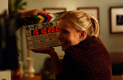

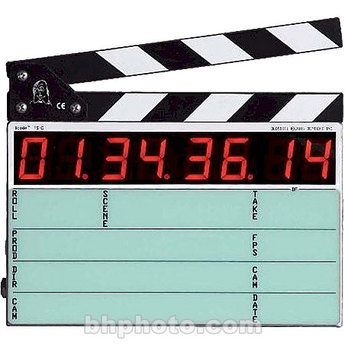

    Most pro shoots will use a time code slate to help sync audio. Audio is recorded separately but with the same time code on a track. That way everything can be matched in post to the frame.
