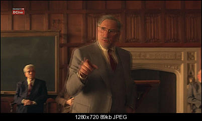

    Often, I have avchd 1080i PAL files that I want to convert to 720p NTSC. Generally, I have good results, but occasionally have source files that don't seem to transcode/convert well. Getting from PAL to NTSC is the easy part. Getting a good transcode of the source avchd file to 720p is the problem I having this particular time. I am using DGAVCindex, MeGUI, and a fairly simple avisynth script. The result is okay, but I am seeing quite a few interacing artifacts in the conversion. In other words, my script does not seem to be handling the source well.

    Simple script?...yes. But this has generally worked for me. I have tried various deinterlacers...yadif, tdeint, TomsMoComp. These generally leave artifacts that tfm does not, and are not doing any better deinterlacing than tfm. On a side note, I use MPC with ffdshow to view these files, and ffdhsow is not deinterlacing them correctly. Cyberlink seems to do the best. Anyways...
    Here is a snapshot of one of many areas where the deinterlacing is going array:
    So, attached is a small clip of the source file for anyone interested. Any help is always appreciated.
    http://www.sendspace.com/file/i092ci (just look for the sample.ts link)
    Thanks in advance,
    David

  3. why 720p60 instead of 720p50 ?
    I haven't looked at your sample, but assuming it's a 1080i50 PAL source, you will get either blends (=blurry like your screenshot) or duplicate frames (= choppy) because you don't have enough temporal information if you try to convert it to 720p60 instead of 720p50. You're trying to generate more frames per second out of nothing . Your starting PAL field rate is 50 fields per second , not 60. So "PAL to NTSC" is not the easy part at all. It shouldn't be done.
    Don't use dgavcindex for interlaced streams, it has well documented problems with PAFF streams (blocky decoding errors). Use DirectShowSource + ffdshow
    TFM is a field matcher, not a deinterlacer
    If you want a great deinterlacer, try tempgaussmc_beta2 , way slower, but much fewer artifacts than yadif or the others listed above , yadifmod+nnedi2/3 is a decent alternative as well

  9. Weel I should have looked at your sample in the first place
    It has field blends
    I would use DSS2() because it's frame accurate . I think you could use a bobber, and srestore(23.976) to return the film rate and get rid of some of the blends
    EDIT: it appears there are stream errors too , that might be another reason why dgavcindex "barfed"

    Here is an oddity. I decided to just watch the .ts file today in all of it's low bitrate glory. Turns out, this is a strange one...Unlike every PAL film I have downloaded, this one is actually time-correct. In other words, it does not suffer from PAL-speedup. It is the exact length of the NTSC version at 23.976 fps. I won't even pretend to figure out why this is, but I am sure however this movie was coded for PAL broadcasting, whatever method they used probably explains why this .ts file is so glitchy.
  21. Originally Posted by djdrock View Post
    That's why it has the field blending. It went though a cheap hardware NTSC to PAL converter that keeps the running time but blends fields to (slightly) smooth out motion.
