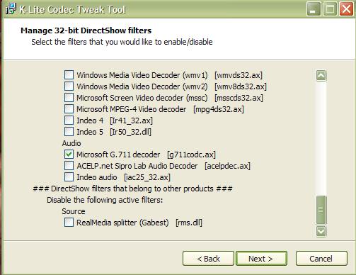

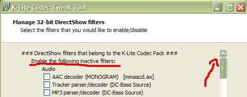

    Using K-Lite's "Codec Tweak Tool" select "Manage installed Direct Show Filters" and look at the MP3 decoders.
    K-Lite probably set ffdshow as the MP3 decoder, you can deactivate that and try the "Windows" ones listed further down, I have "MP3 decoder (Fraunhofer)" which may be what ImgBurn prefers.

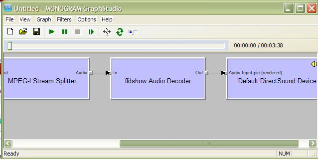

    this was one interesting quote i got though in that IMGburn thread
    D 19:19:50 Filters: Source -> MPEG-I Stream Splitter -> ffdshow Audio Decoder -> MONOGRAM AMR Encoder -> MONOGRAM AMR Decoder -> ACM Wrapper -> Sample Grabber -> Null Renderer
    I wonder if that can be tracked down via the codec tweaker tool also if your way doesn't work?..im gonna perform a
    re-test burn this evening with your (Fraunhofer) setting active, stay tuned! will take the opportunity to keep an eye out for the ffdshow icon also
    I can inform that no audio filter where highlighted inside Direct Show Filters as far as i could see, now there should be one though

    I realize there are other ways to solve this, but i think i wanna be stubborn and really exclude that i cant
    sett this so it disable that filter
    the problem is that the "tweak tool" have a big problem in indicate to its new master what he just manually enabled or disabled, cause the "V" have disappeared when you reopen the filter choice next time
    "enable the following filters" and it will always name same filters as being currently disabled..even though i enabled one of them last time successfully, so how can we ever be sure if it really have enabled or not? when everything keeps default back to the disable list?
    didn't feel any change after the re-burn with (Fraunhofer Mp3) supposable being active
    "Windows Media Audio Recorder" didnt do any difference either
    (was that the filter you refereed to in your first post? cause i cant find any other matching myself)
    Maybe you have a permissions problem.
    If you log on as an admin, you should be able to make changes stick.
    Also try the "Detect broken codecs and filters" Tweak option.
    It has a sub option: "Re-register base DirectShow filters" that might help.

    If you just click on an MP3 file and play it, whatever does that (eg, MPC) should use the same codec as you've chosen.
    If you use "Graph Studio" (installed by K-Lite under its Tools sub menu) and do "File/Render" and choose an MP3 file, it will show you exactly what codecs are used to play it.
    Anyway; I'm still mystified how you can have degraded playback. Usually playing an audio file either works, or it fails.

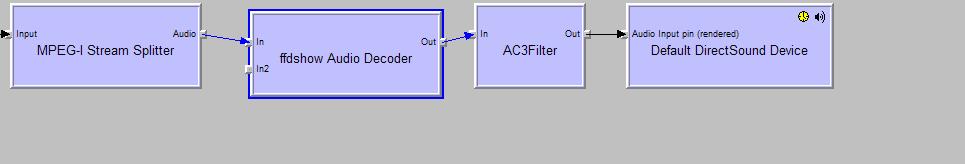

    looking at the attached file..i don't see any big sensations?, the ac3 filter i have just tested to add this last time i installed, i did it since nothing else worked, i have actually during the installation disabled anything audio related inside the K-lite installer, but still i got this sensational degrading audio on the cd
    Im thinking that perhaps i shall uninstall K-lite for a while, but for another reason that the critic in this thread now celebrates ...i having MUSIC issues within Starcraft 2, that the music do not use its ticked setting "continuous music" in the reality, since this codec pack obvious can cause this wery odd
    degrading of the direct show filter, who knows what music related issues it can disturb even in a totally unrelated computer game?
    cause if this cd burning is turn out to be the only consequence it can bring once installed, then i can just as well uninstall it only when i wanna burn a audio cd (that is not so often) and then reinstall after
    cause it goes perfectly to burn "files to folder" file at the same time in Img burn, that im doing a bit more often
    Why im this stubborn is cause i have used K-lite for several years, and it have allays been able to burn music cd's with correct quality, this issue is something new introduced
    So your source files are AC3?
    I had been assuming you were using MP3. I see now that was never specified -- so the Fraunhofer decoder I mentioned is irrelevant, that's for MP3.
    Windows doesn't come with an AC3 decoder (at least not the versions I've used) so you do need a third party one.
    AC3 files can be multi-channel (5.1), CD is stereo. Also they are usually sampled at 48000Hz, whereas CD audio is 44100, so they have to be resampled.
    ffdshow filters can do that, but I don't know how well ImgBurn will cope with it.
  25. I could not see any difference between AC3 or ffdshow, since i dont know what AC3 will affect things at all
    now this is solved anyhow! cause instead of installing "K-lite codec pack FULL"version i just took "standard" this time,
    it highlighted AC3 as default i noticed (it didnt in FULL install)
    but i disabled it and just keep the Mp3 direct show enabled, and now i have burned a cd with optimal quality here
    Now what remains is testing Starcraft 2 without K-lite installed just for safety sake, after that and there is no connection, i at least now know my new installation setup
