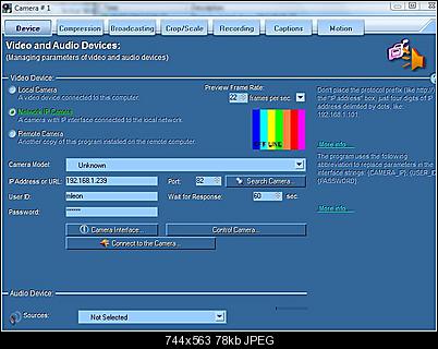

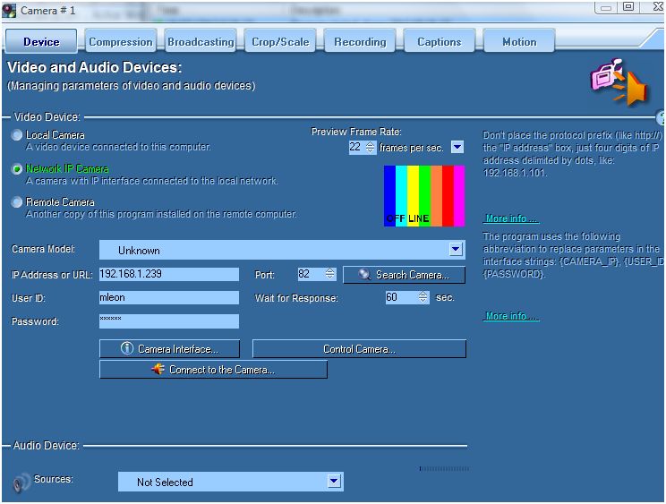

    As far as I understand, I have to put in Active Webcam device setup window (see picture attached):
    • Video Device:
    Network IP Camera = selected
    Camera Model = Unknown
    IP address o URL= 192.168.1.239 (this is my ip configuration)
    Port= 82 (this is my port)
    User ID= mleon
    Password=XXXXXX
    After this configuration, I think I have to push the button "Camera Interface" to access to new window
    • Network Camera Interface - General
    Camera Model= Unknown
    Address of administration web page=
    Address of Camera Web Page=
    String to request JPEG image= http//192.168.1.239/?action=stream/?channel=1.mjpeg
    (I think I have to add my pesonal user/password to this sentence, but I don't know how)
    String to reset Camera=
    Use DLL to comunicate with camera= NO selected
    Many many thanks If you can help me to configurate the camera

  5. You have the settings right !
    You do not have to add un/pw to the request string as you already have this in the device window. After you have done the setup and the video works, then save the setup under the name "Tenvis' and you should be able to go back to the settings in future.
