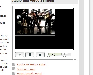

  1. Hello,
    My company's website allows its members to list videos of their work online on their own personal 'press kit'. Until recently, we allowed them to upload several types of video onto their pages, but we've now changed our policies and incorporated an flv only video player. Any new video that's uploaded is automatically converted to flv upon upload - however, we still had about 2000 old videos left in non flv state.
    I've been converting these non flv videos to flv, and have had pretty good success with using my websites upload converter or if need be, sothink video encoder for adobe. However, .mov's have been causing the biggest trouble. The two common issues are that the videos won't fit into the flv video player upon conversion/upload(see attachment), or the sound comes out garbled. With these files, I personally convert them to flv before uploading, to ensure they'll play/fit properly - but the problem usually persists. In the screenshot I've attached, you'll see a video that I converted into flv, into the proper dimensions 320x240, yet no matter what I do it'll appear smaller than it should be, and in the corner of the player. Is there some secret to converting mov's to flv's that I don't know about? I've exhausted every possible solution I could come up with, including converting with larger dimensions, playing with the zoom function, converting the files to another format before converting them to flv - and the outcome is always the same. No one here seems to know a solution so I'm asking for expert advice. The only other thing I can think of is that it's something with our uploader itself, but I don't know how to figure that out/get our tech department to fix it.
    Here are the flv requirements that I'm aware of on our player -
    The conversion process will change the size of your video to 320 x 240 if it's not that size already. Also, the "audio sampling rate" of the video must be 11025 hz, 22050 hz, or 44,100 hz. Otherwise the audio may be garbled on playback.
    and here are the sothink specifications that have worked for (almost) all other file types -
    Profiles: User-defined
    Audio Settings
    Enable audio-Checked off
    Sample rate: 44100 kz
    Bit rate: 96 Kbps
    Channels: Stereo
    Gain: DO NOT TOUCH
    Video Settings
    Width: 640
    Height: 480
    Bit rate: 350
    Frame Rate: 30
    Key frame rate: 12
    Zoom mode: LetterBox
    any direction you can give me is greatly appreciated - including other software, other specifications, ect. Thank you!!!

  8. You can use the program suggested above, mediainfo . Open a flv that you know works with your system , and use view=>text, copy & paste the information back here
    I played with your sample mov , and found a possible solution but it's quite convoluted. I can go into detail, but I can tell you it will be way over your head if you're not already familiar with some of the tools like avisynth . Hopefully someone else can find an easier solution.
    The problem is most of the tools do not decode that mov corrrectly (as depicted in your 1st screenshot), and they pass that on to the encode. If you decode through the quicktime API, then you can get a proper sized image
    For now,
    1) can you test if this attached flv is compatible with your system (i.e. does it play in your company website player correctly) ?
    2) please post the mediainfo text information requested earlier
    3) do all the mov's that you have problems with exhibit the same characteristics? or are they a different kind ? (i.e. you should use mediainfo on those too)

  16. Most of what you're talking about it over my head! But thank you so much for taking so much time looking into this weird problem.
    I tried to upload your video to our site and unfortunately the size issue persists.
    I've converted these other types of files - swf, wmv, wma, rm, ram, mpg, mp4 and avi. I did have a couple problems converting a few of the formats here and there, but could almost always fix the issue by converting to flv with sothink first.
    Other problem upload details -
    1. This mov file fits properly but the sound remains garbled upon upload
    For now,
  17. Originally Posted by KMartin View Post
    Then I suspect there is something wrong with your website software , or it's hasn't been updated for a few years.
    That uploaded file conforms to Adobe Flash specs and plays fine in several flash players including, embedded flash players, and stand alone flash players.
    It seems like your software has issues with AAC audio - all the examples with "garbled audio" had AAC audio . There doesn't seem to be a consistent pattern behind the size issue
    Can you test this attached avidemux converted file?
  18. That worked!!!! Thank you for fixing that. What can I do on my end, or is it too complicated? <3
  19. What worked? The "avidemux.flv" version ?
    If so, I posted instructions in post #13
    I don't know how to use the command line version, but it might be possible for you to batch convert them (e.g. all the files in a folder) , instead of 1 by 1
  20. Great, I was able to do it on my own. It's probably only about 100 files so I can do them one by one.
    You mentioned a problem with our player and AAC audio - what can I do to fix the garbled videos (i'm assuming using avidmux with the MP# setting but I could be wrong) And is this something I should bring up to tech to try and fix (could happen to other people)
  21. Does your software re-encode the user uploads ? like youtube ? or does it take the ones unaltered (not re-encoded) ?
    The reason I say it has problems with AAC audio, is all the examples you posted that had "garbled" audio used AAC audio
    AAC has been used for years now in flash, which is another reason why I suspect the programs used by your website are quite outdated
    There is nothing you can do to a video that has garbled audio already.
    But if you have a non garbled source to begin with, you can use MP3 audio, like the example above instead , or tell your users not to upload videos AAC audio . Or better yet, update the software on your company site. The video & audio compression used is very poor and outdated (translation: low quality and waste of bandwith. Your company could save money in bandwidth costs and exhibit higher quality video & audio by using modern technology)
  22. Thanks!
    We only alter the file if it's not in flv upon upload. If the file is already in flv, I believe we don't change it at all.
    I've been informed that we currently use '.NET media handler pro' is that a bad choice? Or do we just need to update our software? I may be able to recommend something else if it works better, as we do occasionally have problems upon upload.
    I just converted a mov file with the resizing issue, but now the audio is garbled! I'm sure I'm using the wrong setting or something. I did MP3, resampling 44100, bit rate 96. Is this wrong? Here's the original file's info -

    and the file converted using avidemux -
    General
    Complete name : C:\Users\kmartin\Videos\vivalasvegas.flv
    Format : Flash Video
    File size : 24.4 MiB
    Duration : 2mn 26s
    Overall bit rate : 1 397 Kbps
    Video
    Format : H.263
    Duration : 2mn 26s
    Bit rate : 1 237 Kbps
    Width : 320 pixels
    Height : 240 pixels
    Display aspect ratio : 4:3
    Frame rate mode : Constant
    Frame rate : 11.988 fps
    Bits/(Pixel*Frame) : 1.344
    Stream size : 21.6 MiB (89%)
    Audio
    Format : MPEG Audio
    Format version : Version 1
    Format profile : Layer 3
    Duration : 2mn 26s
    Bit rate mode : Constant
    Bit rate : 96.0 Kbps
    Channel(s) : 2 channels
    Sampling rate : 44.1 KHz
    Bit depth : 16 bits
    Stream size : 1.68 MiB (7%)
    if it helps I can send you a link to the page - I just prefer to not post it on the forum
  23. The difference in the audio between "avidemux.flv" and your version is it used a higher bitrate 128kb/s and didn't resample audio to 44.1KHz . (It stayed at 22.05Khz unchanged) . The video bitrates are different as well , but that shouldn't affect the audio
