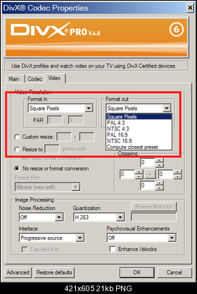

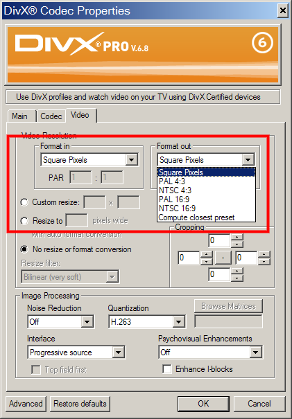

  2. Set the PAR or DAR flags in your output codec. Since you're not changing the frame size set Format Out to the same value as the current source:
  3. Thanks for your reply, just as an experiment (since I still don't quite know how PAR works in relation to the regular AR) I set 'Format in' and 'Format out' to PAL 16:9 and did a test conversion. But the result was the same stretched window. What should I set the PAR to, for a 2.35:1 AR video file?

  8. You have two choices:
    1) Resize the frame so that the relative frame dimensions are equal to the Display Aspect Ratio (DAR, the final shape of the picture) and encode with square pixels (Pixel Aspect Ratio = PAR = 1:1). For a 2:35:1 video that would be about 400x176.
    2) Use any frame size you want and encode with PAR/DAR flags to tell the player what the final shape should be.
    DAR = PAR * SAR
    DAR = Display aspect ratio, the final shape of the displayed picture
    PAR = Pixel Aspect Ratio, the shape of individual pixels
    SAR = Storage Aspect Ratio, the frame dimensions.
    Some players don't respect PAR/DAR flags. Most current players will respect PAR/DAR flags of Divx AVI files. You may need to enable it in the player.
    It's impossible to tell you the exact settings to use with your current video without knowing exactly what you have. Post what MediaInfo tells you about the file. Your earlier attempt probably didn't work because you set Divx's input AR and output AR to the same settings. The input AR needs to be set to the input file's PAR. Since you told it the input AR and output AR were the same it didn't do anything to the video.
